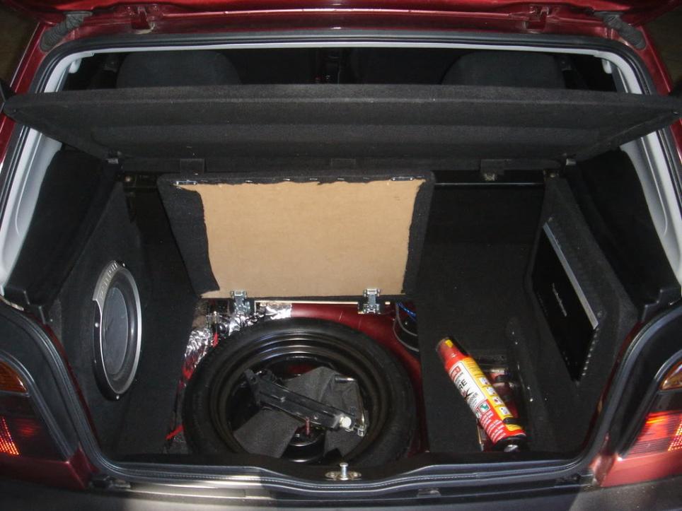

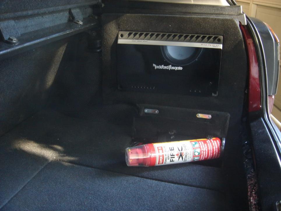

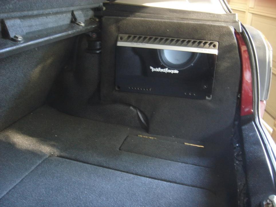

    finially had chance to post pics, enjoy.

    Very nice boot install tho, well done!
      very clean boot install..

                        Very nice install there mate, love the neatness of it all and the falso floor, something Im gonna do soon when I get a chance
