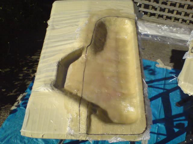

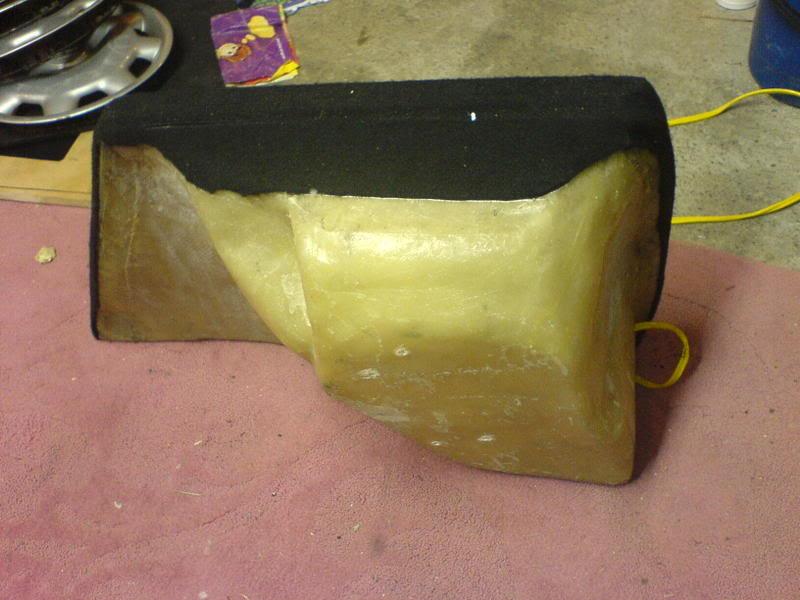

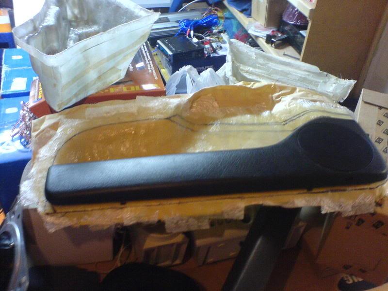

                  • #39
                    Pictures as requested

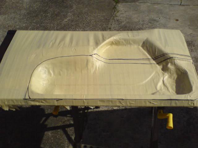

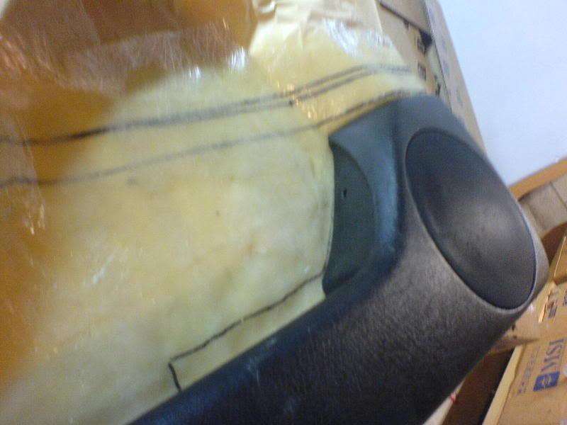

                    • #40
                      showing the doorpod and speaker space.
                      As you can see the pics of the second photo. You can build the Pod out to that point for 2 reasons.
                      First it will give you around 3-5 litres of space for the mids. Or if you want to do dual mids or 3 way.
                      Second reason, that you still get to use a door pocket in the car.
                      The size of this pods applies to the 3dr and 5dr golf.
                      Hopefully Mr Charisma can sort of see the little bit of space there surely's not behind the mid.
                      Hope this clears up the confusion.

                        • #42
                          THanks for the PICs Glidn
                          But I am bit confused to what a door pod is, so this freshly made fibre glass .........
                          IS A DOOR POD??? So bascially you molded another door ??
                          OR this fibre glass is connected to the metal frame and door card is snapped back ontop ????
                          I think I really need to see the finished product to understand this.

                          • #43
                            the pic you have there is merely the rear side of the doorpod. As the mk3 door is kind of a crappy design, the 2nd photo i showed that would be your standard door pocket. But think of that built out to the black line.
                            Then you can angle your speakers and build it to that. Then merely screw the whole pod to the door skin. Then once door skin is back on the door. Take 2 to 3 screws and screw them all the way throught the pod into the actual door. That way you get the proper bracing. Or you could put a wooden spacer behind the door skin, then merely bolt the doorpod / doorskin to the spacer. That way you still get structural rigidity.
                            if this make more sense, thats great. If not. I dont really have any intention really of finishing the door pod as i dont own a MK3 anymore.
                            But who know's i may finish them if i'm going to be playing around with one of our eurosport friends mk3's.
