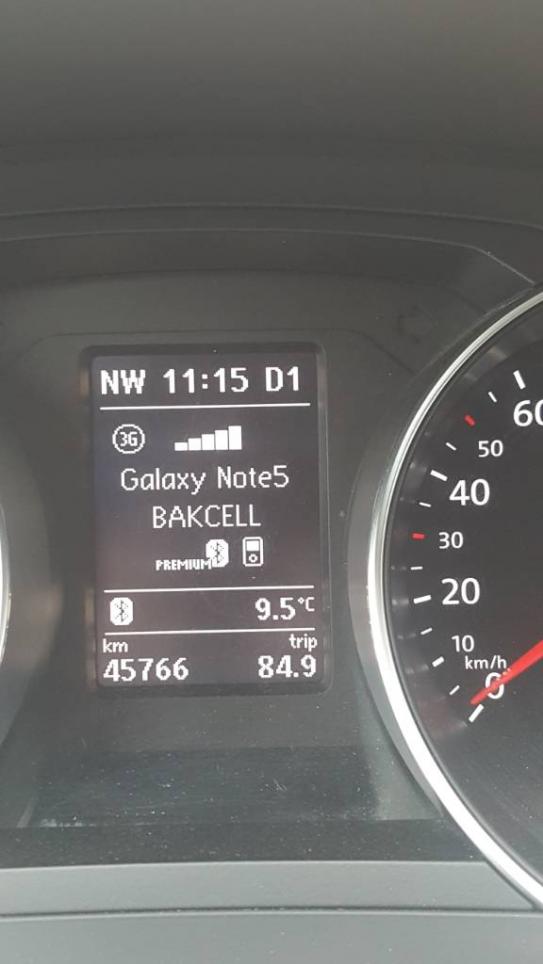

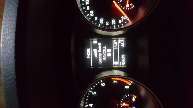

        • Hi All. Recently installed premium BT 3C8 035 730C with rSap support. The issue is that sometimes I see Premium label on MFA+, but sometimes not. Second one is that sometimes when I connect to vehicle's BT, mobile data on my Samsung note 5 phone is switched off, but sometimes keep working. Has anybody faced similar issues?
