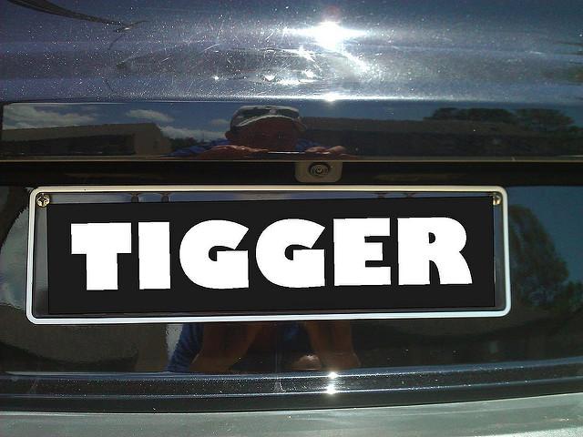

              OK. I promised I'd post a photo so took one on the weekend and just got around to loading it up.
              The camera just peeks out from under the rear hatch if you're down low.
              If you're looking down from above, you can hardly notice that it's even there.
              There was no cutting of the boot required. The old boot handle and new handle fit in exactly the same location - except the new one has a small part of the rubber section on the right end taken up with the camera.
              I actually find it useful for locating the boot handle. Instead of groping around hunting for the handle if you take a look for the camera and then put your hand directly left you get the boot handle first time every time.
              Added bonus and not a feature that you'd see the advertising material.
