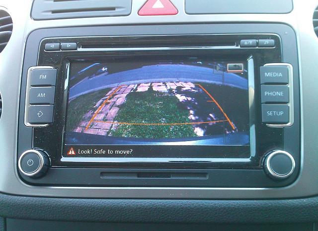

            OK so the RVC from our Chinese friends is in and working. I've got it hooked up to a near new RCD510 head unit and picture quality is reasonable.
            Thanks for confirmation Transporter you were right - the red/black is 12V, brown/green was 0V and blue/black is connected into the reverse light to switch the unit on/off.
            I connected the brown/green to the top of the hatch/boot, the red/black to the centre pin of the power socket in the boot (left side) and ran the blue/black to the right side to pick up the reversing light (as there were no reverse light wires accessible on the left). Things were made simpler for me as my reversing sensors were already connected in here and I just picked off the same wire as the reverse sensors were connected to.
            Anyway so the units seem to work OK and for $120 (and a few hours pulling trims and running wires) it's a worthwhile investment.

              ...and I must say the picture looks good. It has more fish eye effect than the OEM camera but the colours look good and the resolution is not worst than the OEM rvc, it may even be slightly better. I will be fitting in in the RS Octavia next weekend.
