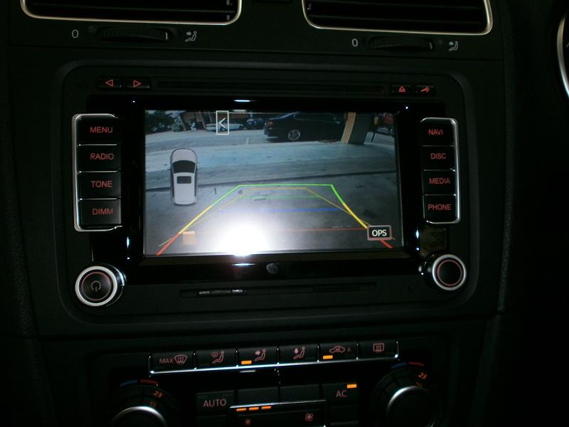

this is what my rvc shows...Originally posted by DkN View PostThat's correct. If you did chance upon a camera with hard coded lines it would show triple now. So for others sourcing cameras from elsewhere, it's still important to get one without hard coded lines.
is the red arrow pointing at the hard coded lines?
Yes.. you need a cam like in my post earlier with no lines if it bothers you.Originally posted by a803sgo View Postthis is what my rvc shows...
Some other brands of navis dont have those lines so the cams provide a distance reference.Prev 2008 R32 3 door DSG.
Prev 2010 S3 Sportback Stronic.
Now Lexus IS350 F Sport
Yea..that static lines was pointing you the distance of if any object at the rear to your bumper, the red static line was the closer to your bumper and some will be shown as this;
