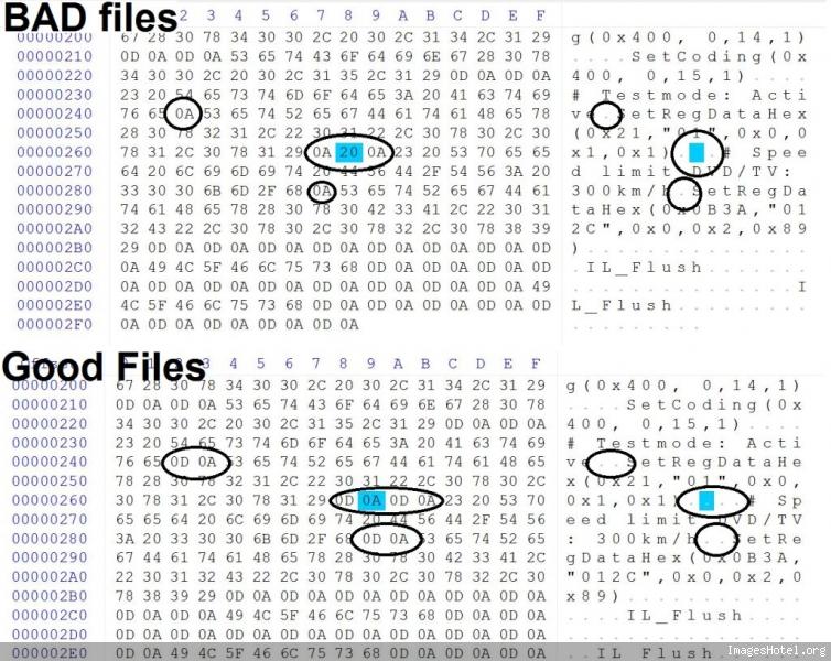

                        • Hello from France,
                          If I am not mistaken, it seems to me that it has errors in files modified in firmwares FW_4020_70_20_5.iso and SWL_CD_4020_M3_EUR.iso
                          in EURPQTO.WSH It is written
                          # Testmode: ActiveSetRegDataHex(0x21,"01",0x0,0x1,0x1) # Speed limit DVD/TV: 300km/hSetRegDataHex(0x0B3A,"012C",0x0,0x2,0x89)
                          He It should be written :
                          # Testmode: Active
                          Same in EURSKHDD.WSH
                          The code of the character "return to the line" is not good.
                          Excuse me for my bad English and I am not a specialist, but some meet problems with these firmwares

                          • The delimiter of 'return' or next line is not required. It only makes it easier to read for humans.
                            Some people have loaded the firmware without issue. Those that fail are likely due to media read errors.
                            Feel free to edit the file as you like, this file is not protected by a CRC.
                            Sent from my HTC One X using Tapatalk
                            • Hello,
                              I do not agree.
                              The code 0A is not enough to indicate the beginning of the line of command. Like the "bad file" program undestand all as line of comment.
                              If "test mode" is a compulsory data to be configured, the program stop and fail.
                              Can be it is the same matter for the formatting 75-20-5
                              • Test mode is optional.
                                As you have pointed out in your image, there is a . in between the comment 'test mode: active' and the actual setting 'setregdatahex'. You can have one . or you can have 99 .s and the setting will still be applied.
                                The formatting is controlled by a script file that is CRC protected however so it cannot just be edited without affecting the resultant CRC.
