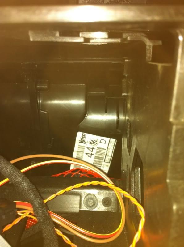

edit: Tested on a version D unit only. No reports of it working on other units yet, please read thread of info.
