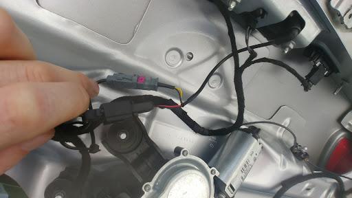

    So I decided to pull the rear panel off the tailgate and take a look at the camera wiring which is where things get interesting. There are 6 wires coming off the tailgate handle:
    2x black with their own harness - presumably for the tailgate latch.
    4x coming off the camera:
    red and black to their own harness. I measured 6V across these wires when reverse is selected (tailgate up) and nothing when in Park.
    yellow and black to a shielded coax-style connector (grey with purple in photo)
    So this is not an RGB output then?! But rather looks like coax? Anyone familiar with this?

      The highline camera module (ie with bending guidelines) has a composite camera that connects to the camera control module which is in the right hand side of the boot behind the removable trim panel. It's mounted on the floor.
      This module takes the camera image and overlays the guidelines with data input from the steering angle sensor to produce the moving lines.
      Yes you could bypass the RVC highline module and feed the composite video straight to the head unit, losing guidelines and gaining some image quality in the process. You would need to add a digital delay relay for power, triggered off the reverse light circuit.
      However you would in general want to keep the highline features, as you mentioned.
      I don't have a RCD330G nor have I seen one. I have a Discover Media which uses the same composite video input however. In my case I upgraded my highline RVC module to the 7N0907441B from My16 Tiguan as it provides the guidlines, but outputs composite video rather than RGBS.
      In theory you should just be able to convert the RGBS video output from your highline RVC module to composite and configure the head unit for RVC low and it should work.
      I have done this on a couple of Mk5 Golfs with OEM lowline cameras to Discover Media and it works perfectly as long as the adaptation channels are correct.
