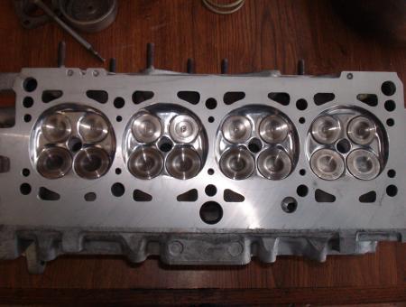

          By the way Stu, here's my head, Ports mostly finished. Awaiting the seats getting cut and the throat opened up for the bigger valves.
          What do you think?
                    What do you think?
                    Looks good - anything's an improvement

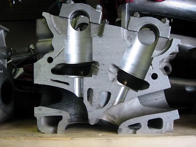

                    Here is a 9a head we cut in half. Look at the angle of the exhaust valve in relation to the port, and also the ridge protruding into the intake port (one of the first ports of call with head work... no pun intended!)

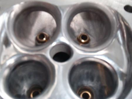

                    My Dbilas head using an early ADL (European 1.8 16v Ibiza with Digifant) casting with narrow ridged intake port:
                    Chambers polished up to prevent carbon build up:

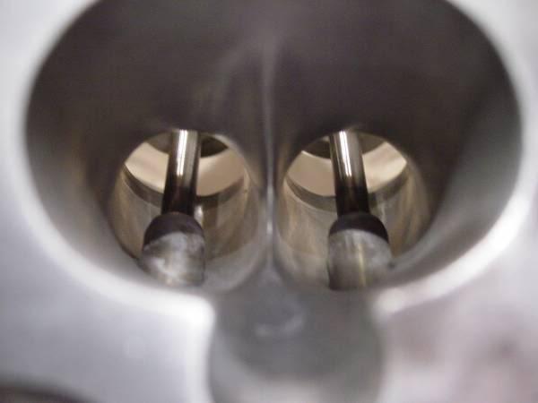

                    Intake ports left coarse for good mix-up

                      You can see that the exhaust side is basically exiting at a 90deg angle, but then if you open it up too much, you lose a lot of bottom end... stuck either way really. The sharp-cornered lip just off the valve seat can be smoothed right over within reason, but it's quite hard when the head isn't in two pieces like the one above!! I can't speak from experience - never done one myself, just had the process explained to me to justify a big expense (!) - but they say it's a very hard head to work on, which is easy to see with the cross section pics.
                      Other problem is that the exhaust valve is too big in relation to the intake valve (according to theory anyway), which is why you go up 2mm to 34mm on the intake, but only up .5mm to 28.5mm on the exhaust when going to bigger valves
