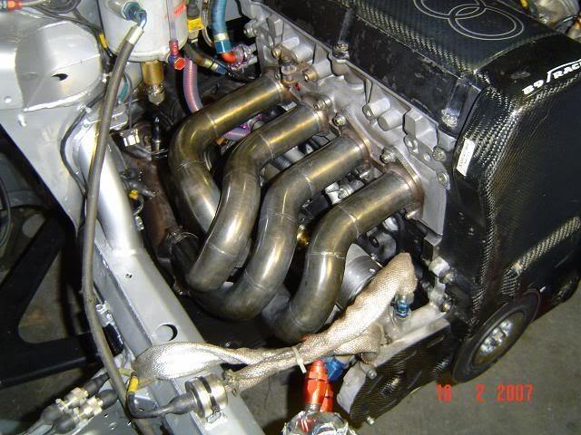

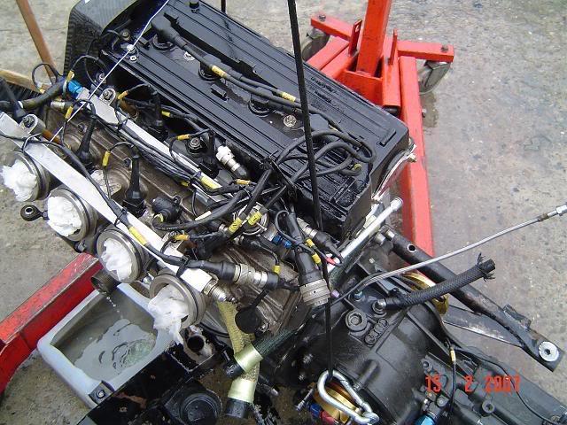

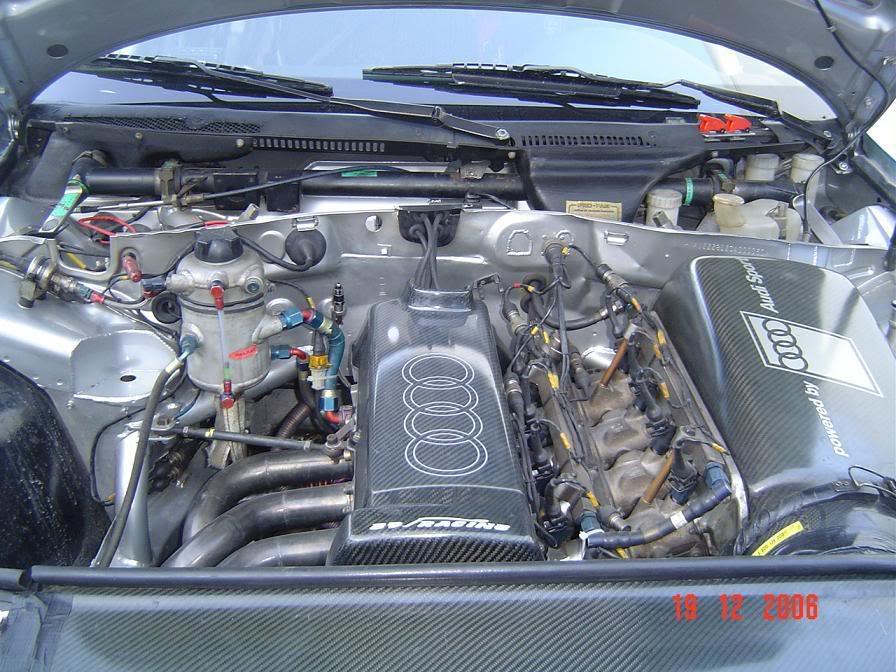

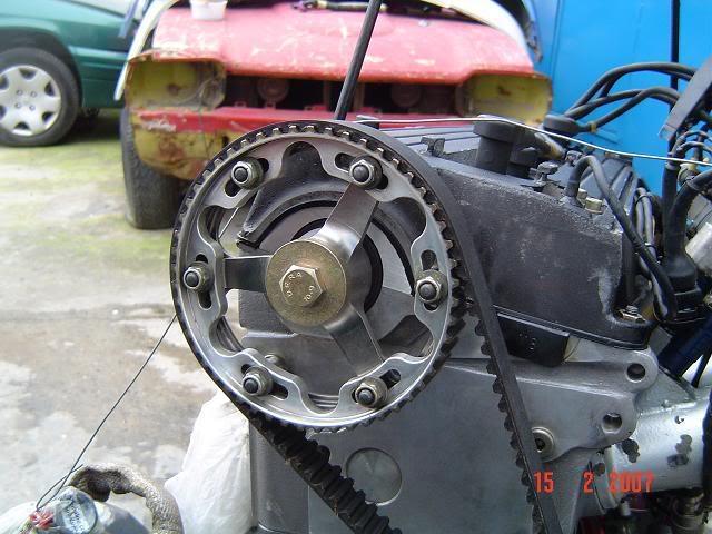

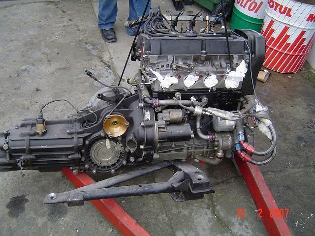

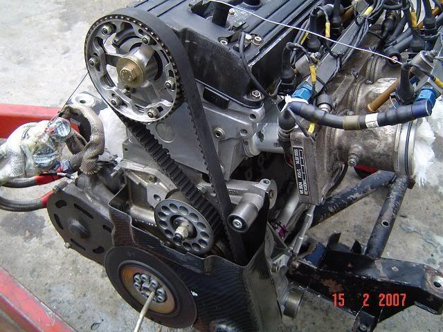

      Originally posted by 16v80 View Post
      Audi A4 btcc touring cars had 2L 16v engines in them 96 on I think,
      depending on the year these were either 295 or 305 BHP,
      These engines are N/A,
      From what i can find out they are basically 6A engines, solid lifters, big cams, throttle bodies, they produce max power at @8500rpm,
      In my opinion these are the ultimate 16v engine, imagine this in a stripped mk1/2 gti
      That 16v is sex on wheels! omg. looks like slide throttle bodies aswell!
