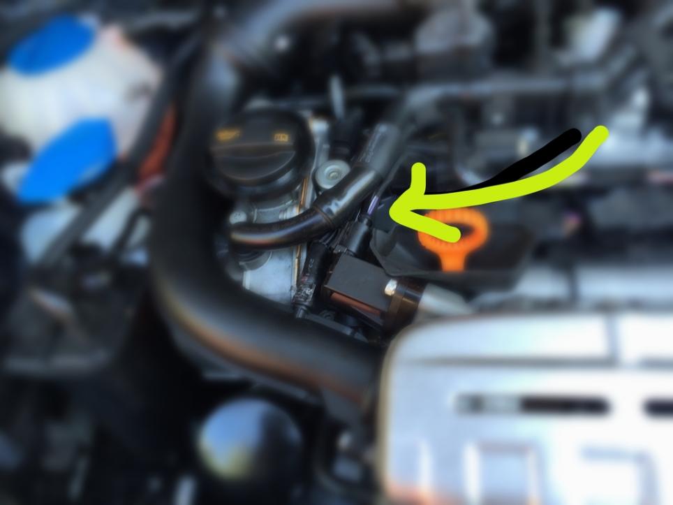

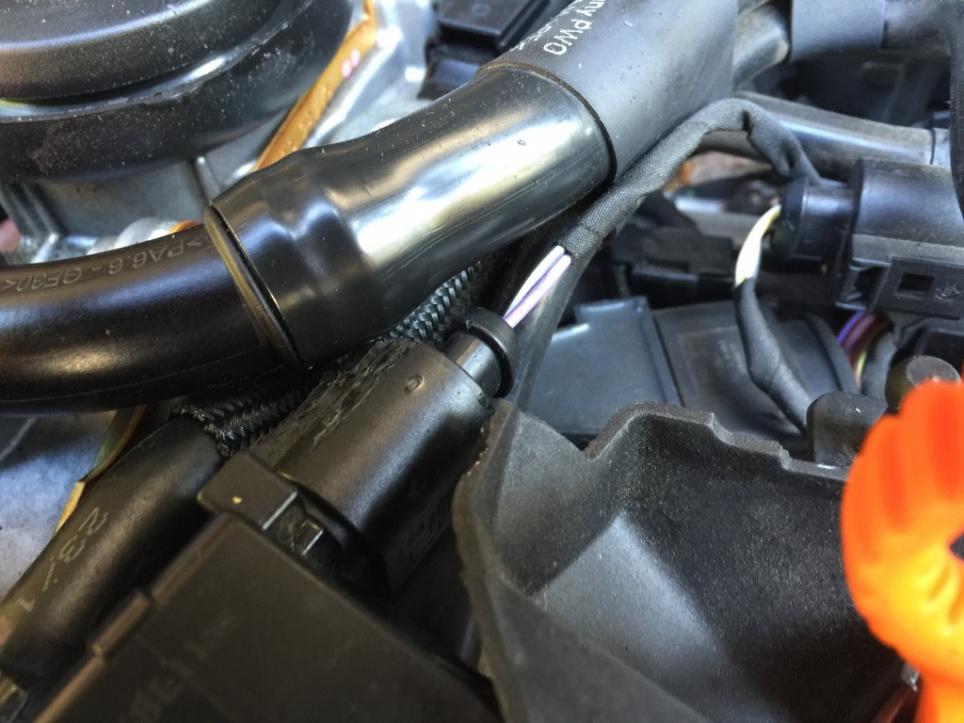

    I got round to installing my DV+ today and ran into a small problem. The plug at the back of the DV now sits back an extra few mm so can't be plugged in thanks to the pipe that lives behind it. (Some sort of vent pipe?).
    I had to unscrew the pipe to get enough clearance to plug in the DV, then realised it would be pushing against the clip and it's hard edge might dig in and damage the pipe. A little dremel-ing fixed that problem, but I will have to unscrew that other pipe anytime I need to unplug the DV (although lets face it, that's probably the easiest part of getting the DV+ out anyway).
    Has anyone else had this problem? Or are things slightly different on the Polo GTI? vs the Golf? (or Audi A1?)
