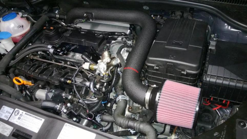

                        am interested in getting a tune for my 2011 Golf R DSG, not so much for power, but more to make it more 'driveable': leaving the car in D it shifts way too soon, its like its in a rush to get to 6th gear, leaving me laboring around everywhere, and S its just stupid in my opinion, holds the gears way too long, i look like a tool driving around revving at 5K rpm in 2nd :p
                        my only mod is a neuspeed intake (stock google image)
                        which to be honest i got more just for sound, as the Golf R is very quite compared to the GTI

                          Luckily, DNA offers a 14 day (or it might be 30 day?) refund policy if you aren't happy with the tune. The Australian distributor for DNA is also based in Melbourne so it couldn't be easier for you to try it.
                          My car is a manual....BUT i do believe the DSG tune is altered slightly when the ECU is tuned which may assist with the issues you are describing above.
