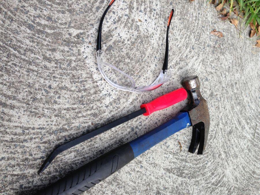

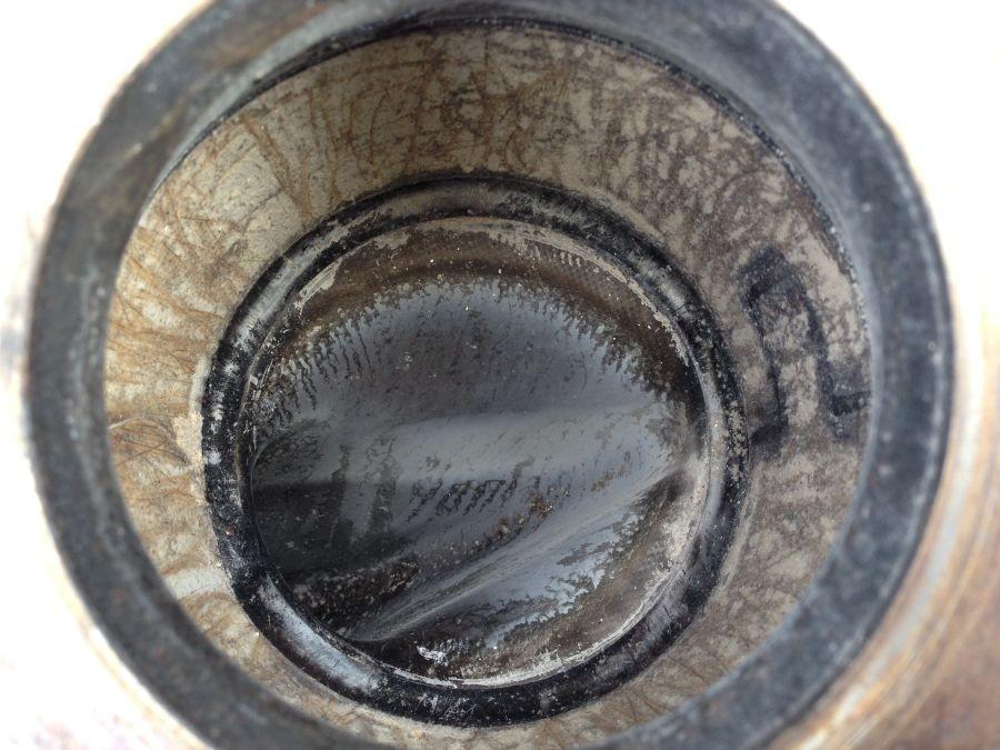

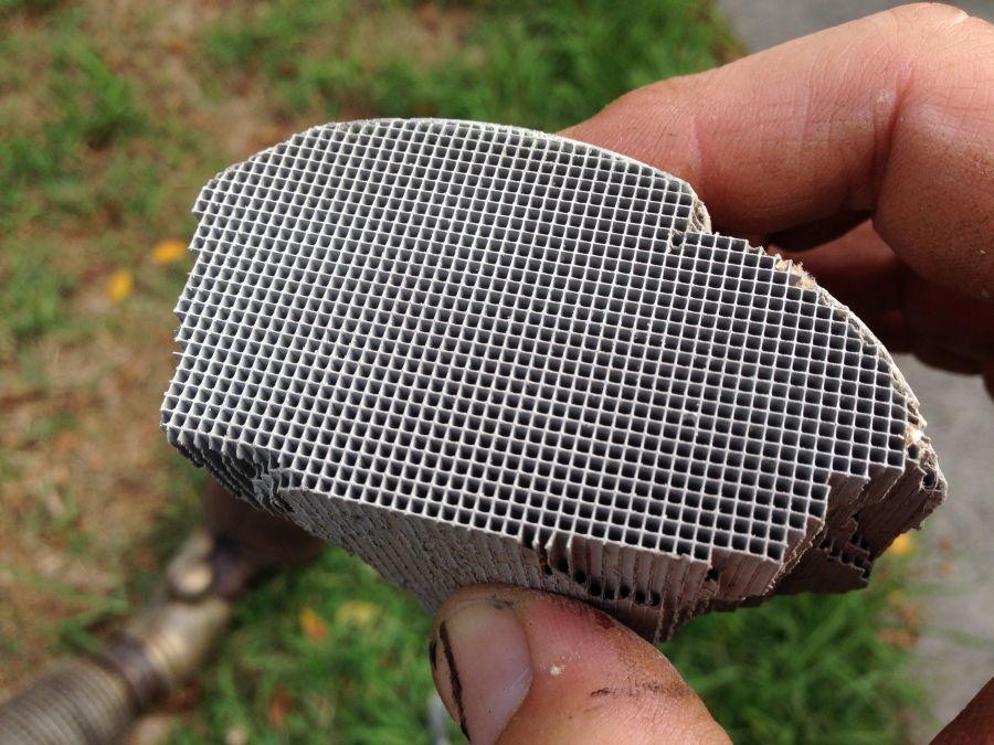

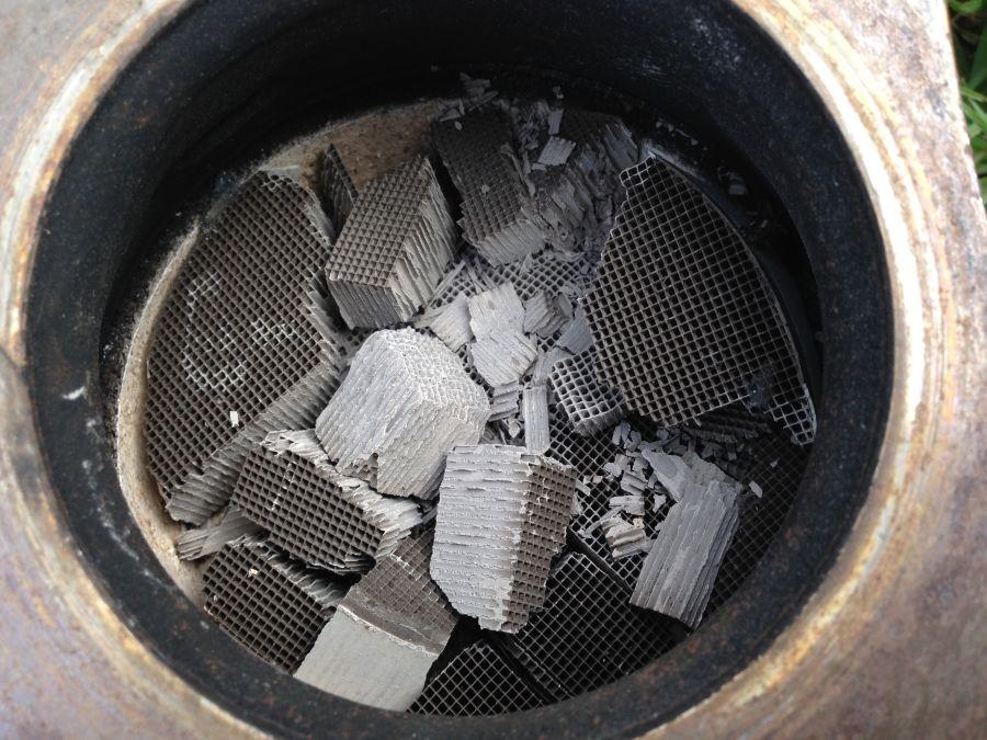

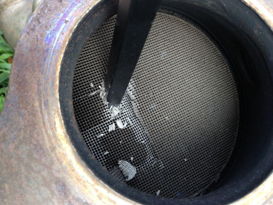

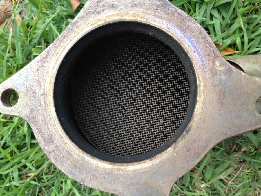

                        Ive never personally seen the cats on a 1.4 twincharge engine, but have many times on Mk5 Golf GTI, Mk6 Golf GTI and Mk6 Golf R (which all appear identical) and can tell you they are a brick wall (very dense and restrictive).
                        On the GTI and R the downpipes actually have 2 cats - one right up near the turbo (which can be DIY removed easily in about 5 mins to reduce restriction and increase airflow) and a secondary cat down under the car. This secondary cat could be easily cut out and a new hi flowing cat welded in its place.
                        Surely something along these lines can be done on the 1.4 twin charge?
                        Pics for inspiration (my Mk6 Golf GTI)
