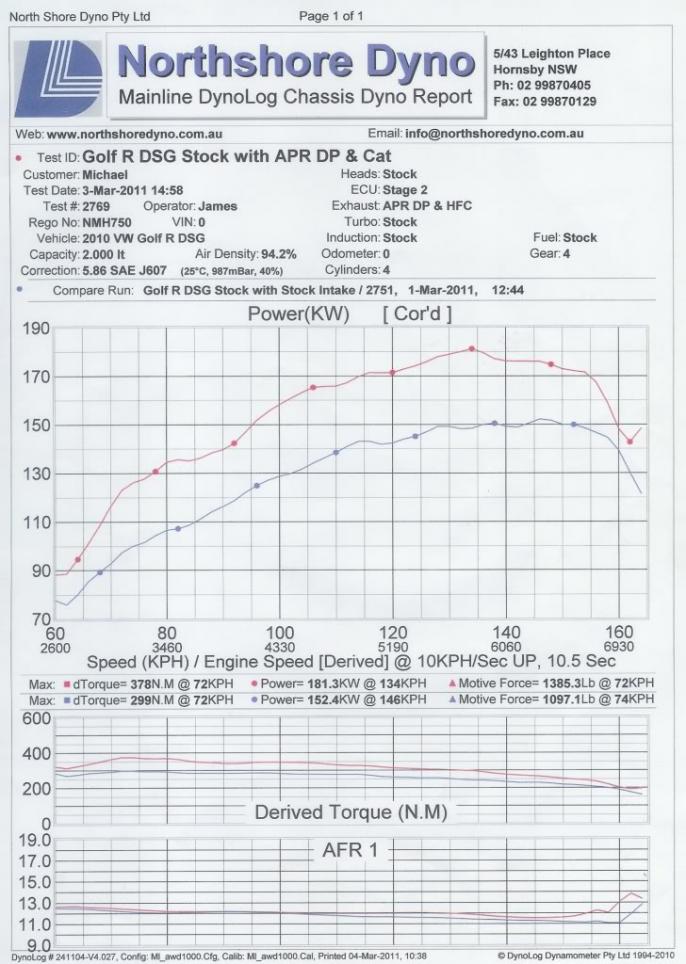

              Was back at TXS today for Mark to run some logs now that the TXS DP is on my car. Had some fairly interesting results:
              Here is stock vs the APR DP which we did back in March and is the set up that I ran at the dyno day the other week which resulted in 197.9 on the day:
              Couldn't remember exactly which stock file we'd used on the last comparo when we ran today but the one we used was fairly close. Here is stock vs TXS DP today. The tune file is untouched:

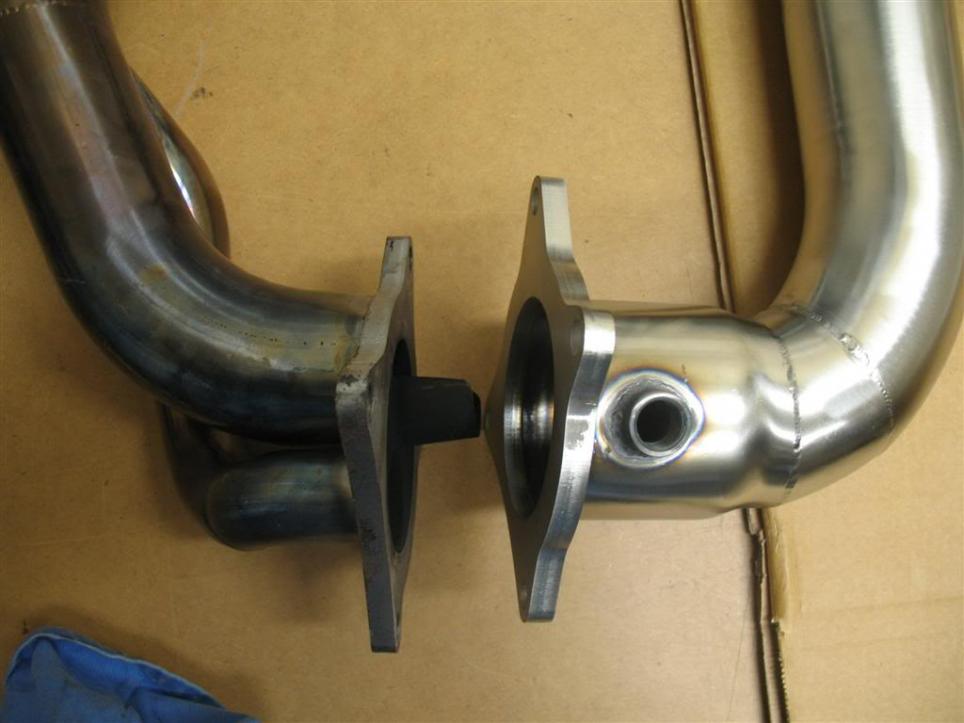

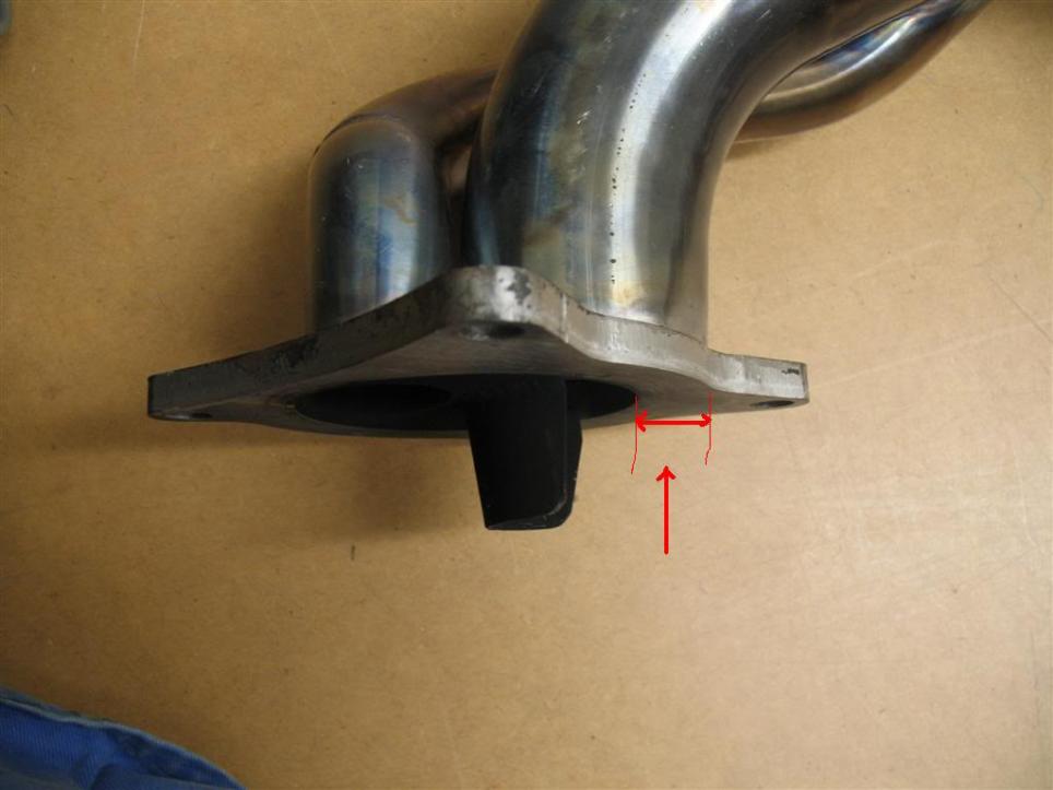

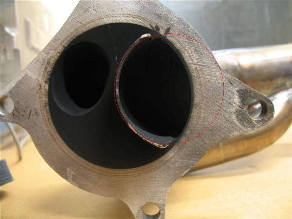

                        For those that may doubt the results and for those that are interested I have some photos to compare the APR and TXS downpipes
                        Top view of both together
                        Top view of just the APR
                        Front view of the APR so you can see what the exhaust flow out of the turbo is up against

                          Haha WTF is with that? Seems like half of it is blocked up!

                              lol... The turbo opening isn't blocked by the red marked areas of the APR exhaust in the pictures above... the red circle is where the 3" pipe attaches to fine, but the turbo output goes into the "black opening" which from the photos is the same size on both exhausts.
                              The difference is what's past that opening. It's the often debated argument between a "bell mouth" and "divorced" turbo down-pipe design. In a bell mouth design such as the Turbo-XS, the turbo output and the waste-gate output flow into the same "mouth". In a divorced down-pipe the waste-gate output flows into the divorced pipe and is merged in with the turbo output further down the pipe.
                              There are pro's and con's for both designs.
                              Which is better? I've no idea. I'd say it depends on the engine and turbo in use.
                              But lets not post up pictures with MS paint red arrows and circles which incorrectly claim that one is blocking half the turbo's output - because that's not the case.
                              Other than that point, thanks for the photos

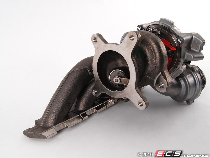

                                to put it all in context
