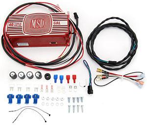

                            • Well.. As Tim delicately put..
                              They've got enough spark to jump start a dead hooker!
                              And i just bought one.. 40th Anniversary edition and all!
                              MSD Ignition 6440 MSD 6-Series Ignition Box
                              Ohhhh yeah.
                              • Nice, best in the business! (and the 40th anni boxs look cool as too!)
