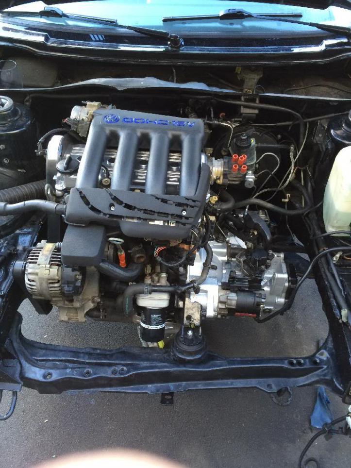

I've got a mk 3 subframe, (VR swap) and all I did was chop down the rear mount around 15 or 20mm.
I used to have a mk 2 front engine mount (unmodified and standard) and modified the bracket (hybrid mk 2/3) to suit the 02A. Using the standard mk 2 crossmemeber. I found that the engine had unacceptable amounts of rock., ie when coming off the throttle at high rpm.
I have since upgraded to a toledo/passat/corrado front crossmemeber (mk 2 fitment, but with a mk 3 mount system) and run a factory bracket (unmodified) with a mk 3 BFI insert. Much better, no issues with rubbing/knocking.
