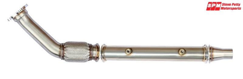

now has one of these:
from Tim at Dub Addiction
