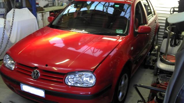

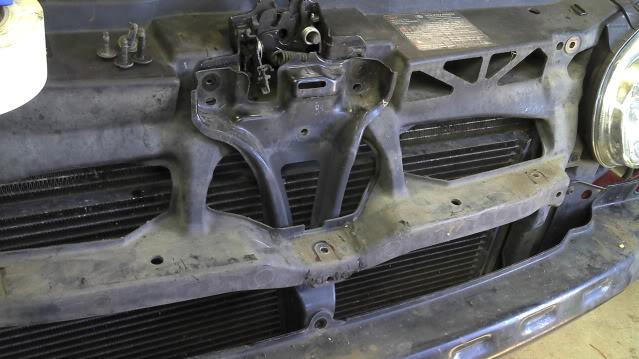

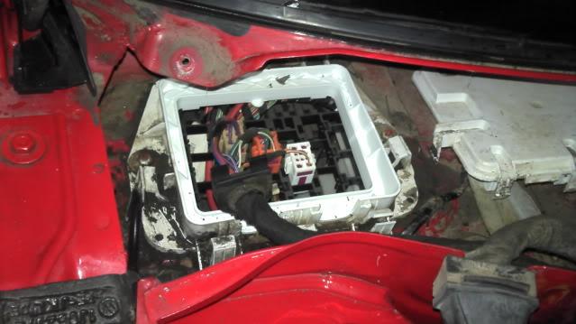

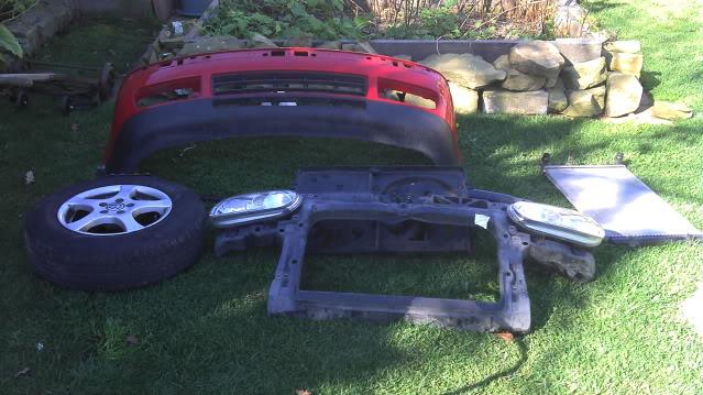

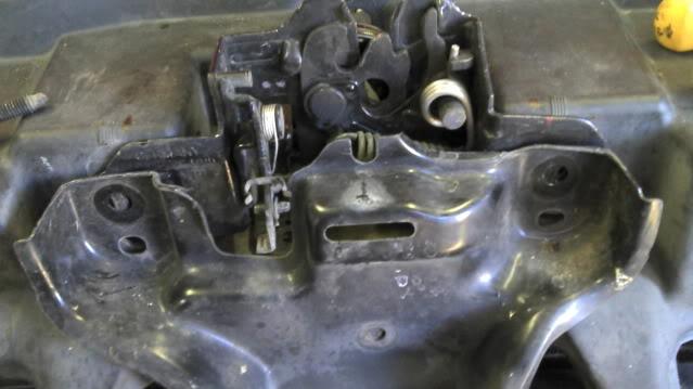

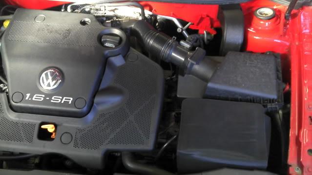

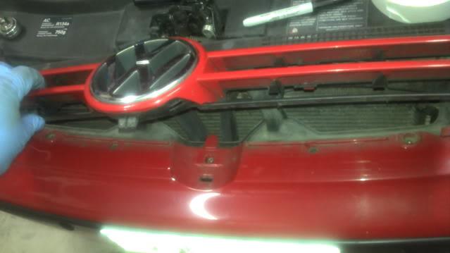

I have a 1.6sr mk4 Golf MY2000, the car in my sig.
Actually a nice little car, but I wanted more zing.
I am a guy - so i decided to pull a perfectly working daily driver apart and make a project of it.
So at this annual leave I decided it was time. Parts were sourced mostly through Matt at Camden GTI - a nicer guy you won't find, and some invaluable advice as well - like "Dont build a car you can buy..."
Other bits like wheels and brakes sourced on the forum here.
I gave myself 2 weeks and so far it has been three, with wiring being the main issue (it could also be ECU related), and the car still not on the road...

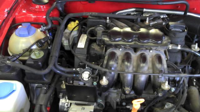

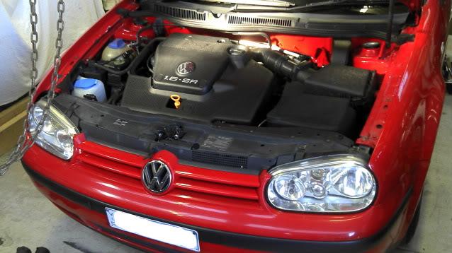

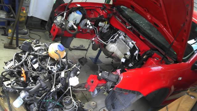

Base car is an 2000 model AKL VW Golf Mk4. It is supposed to be a special edition, but really it means a rally with pretty seats. About 220K klms on the clock and a nice straight runner, with a nice body. Engine is fine, it's just that it is the 1.6

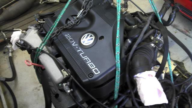

Engine is an AGU Audi A3 1.8 Turbo, stock.

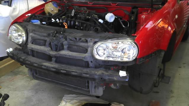

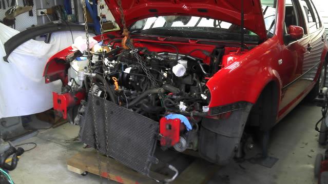

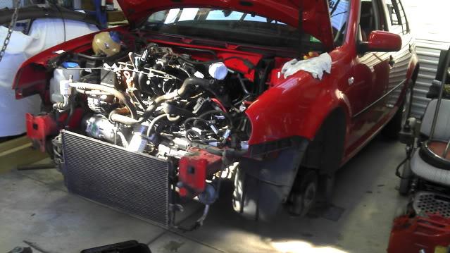

I got the entire front subframe, engine, gearbox, driveshafts, ECU and Loom (well most of it), exhaust and ancilliaries except for the Aircond compressor- but I had one of those.
I actually left the AC and braking circuits in the car , undisturbed to do this.
AC became tricky to work around, but it worked.
This has step by step pics but here are a couple of teasers to start you off:
remember this was a working daily driver.

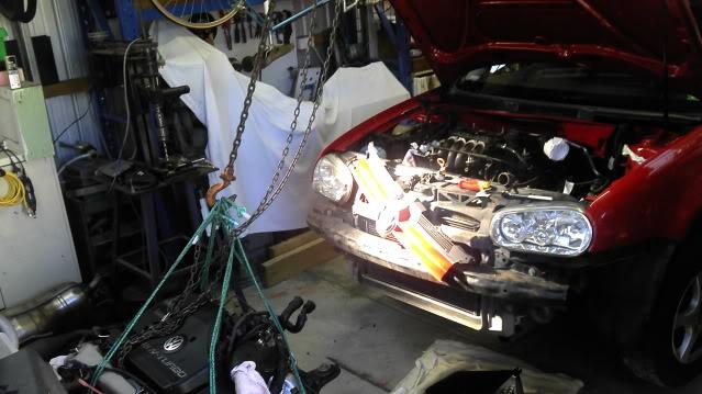

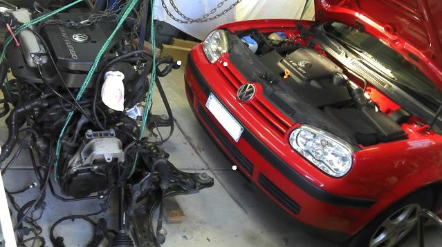

Build was commenced in a garage slightly bigger than a single car one.
Suffice to say, it's taking a while and Mrs Stan is not impressed anymore...
