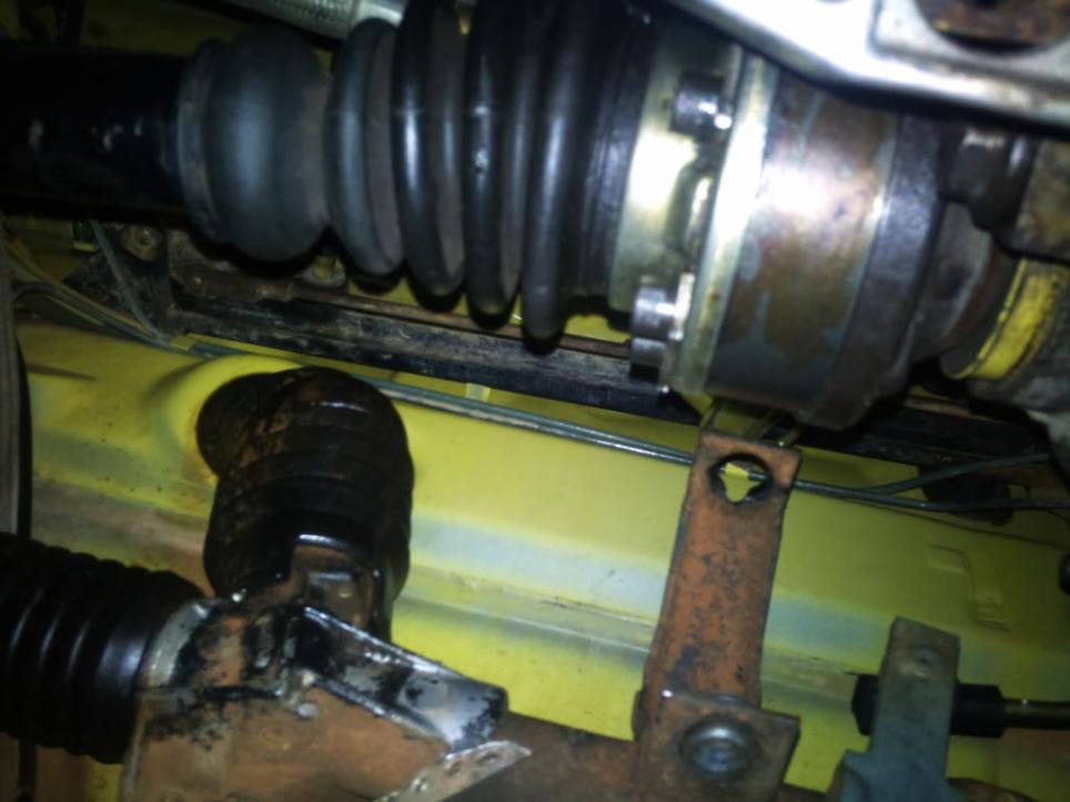

    Nah mate, when it comes to wiring i'd have to pass. I sent the loom and throttlebody for them to modify. The driveshafts are bolted up, Turbo inlet pipe is on and re-routed the water lines that go to the heater. Also, I have to modify the one shifter linkage as it swings against the compressor housing. Will post pics up later.

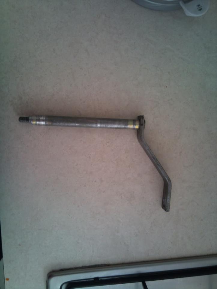

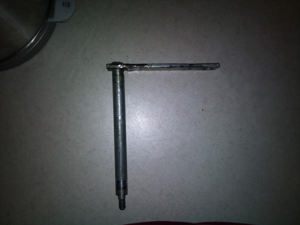

      Not alot done so far but anyway...
      The linkage that i had to modify to clear the compressor housing
      To this
      Now i've fitted the 5 speed linkages and it's still a 4 speed. Is there anything else i need to get/modify to shorten the side to side movement to engage 5th?
          I hope you made the centre to centre distance of the shaft to the linkage hole about 40 mm longer, that will give you a shorter shift , Check it doesnt bind when moving thru all gears.

          • #50
            It's doesn't bind mate, it's the same as it was with the old 4 speed. The distance between the holes are exactly the same as the stock one so no short shift. Damn!

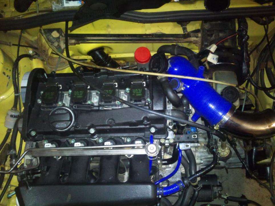

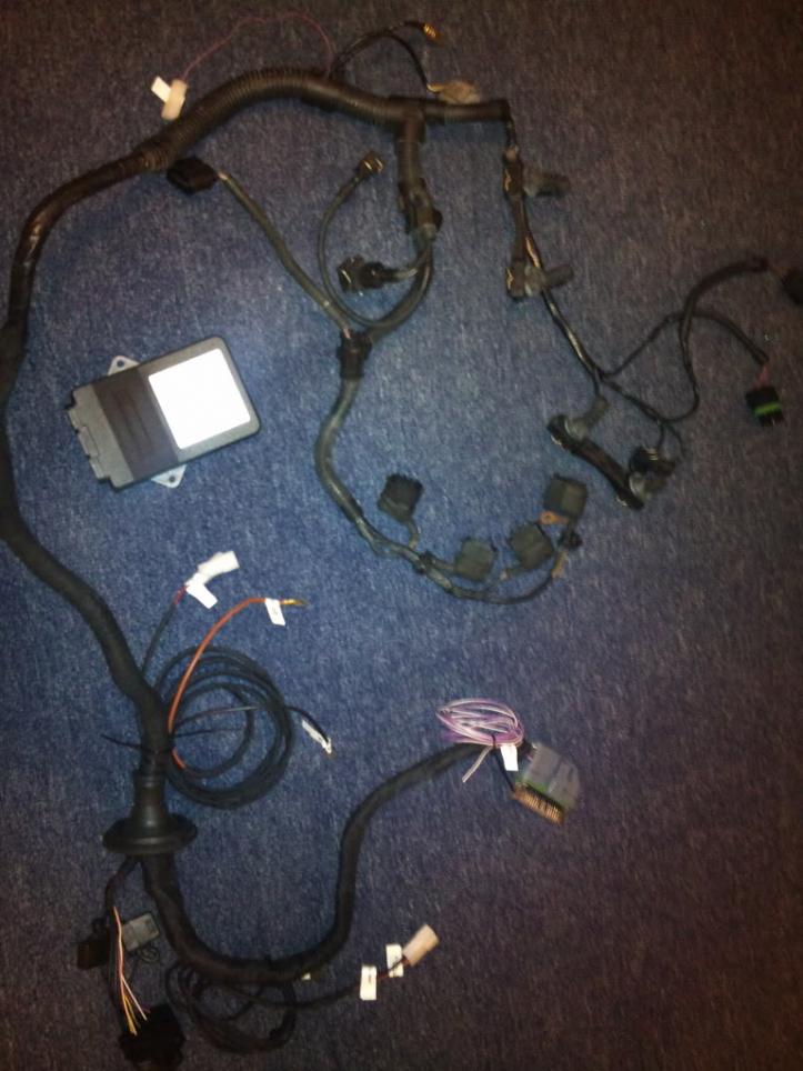

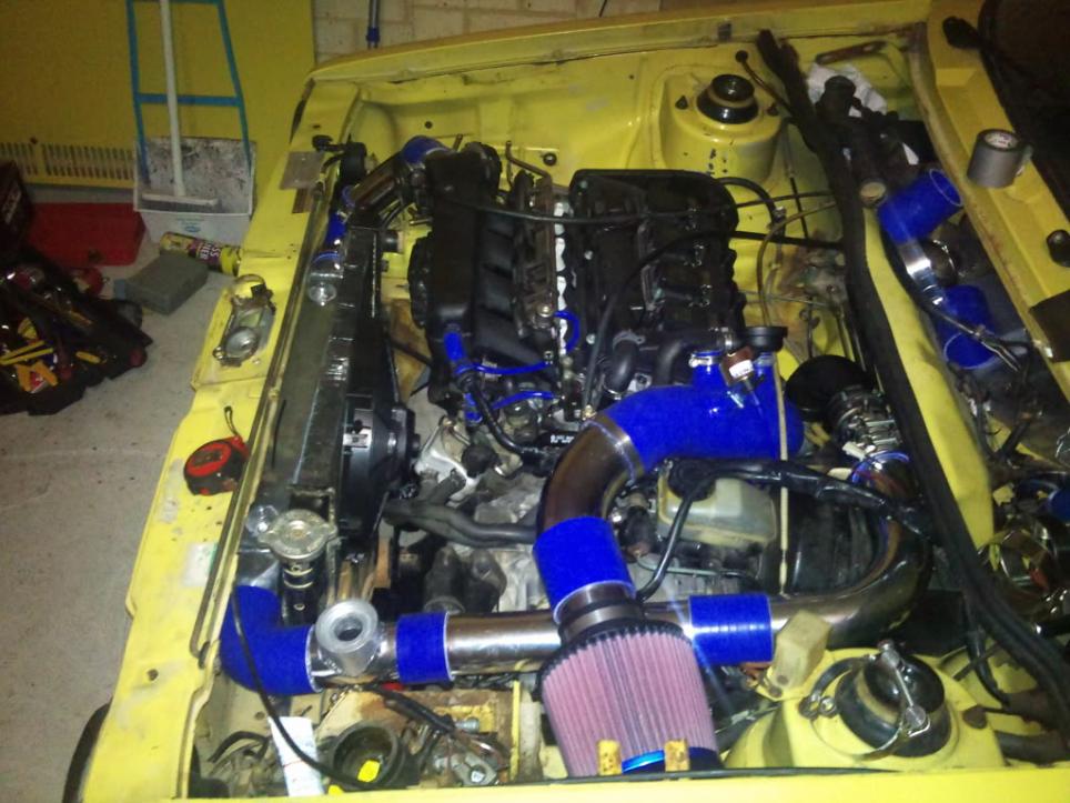

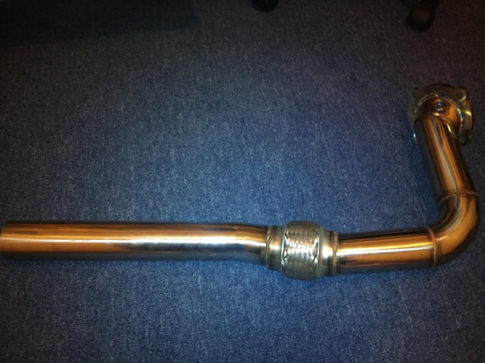

              Time for a update, sorry guys wasnt slacking just away with work. Got the Qpeng management with harness and downpipe. Mine's setup with High/Low boost switch and all relay's for the fuel pump.
              The downpipe..

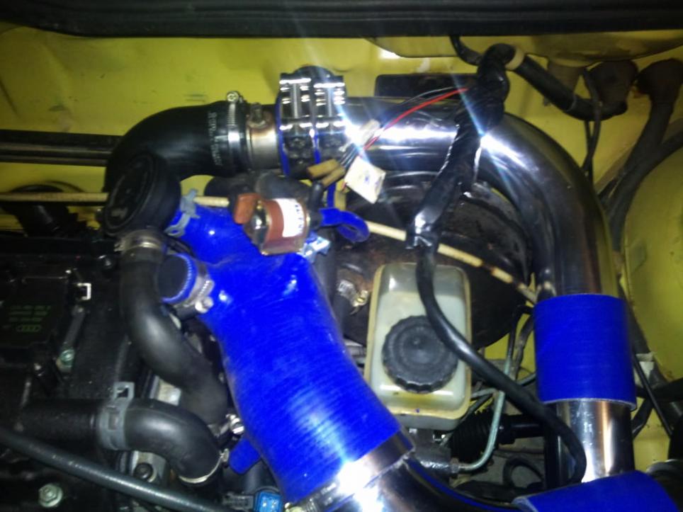

              I also started mocking-up the intercooler piping. Just need to use 1 part of the original piping which got the little 6mm nozzle for the boost controller.
              The intercooler will be mounted low to give sufficient space for the throttle body piping. I wanted to fit the dumpvalve before the throttle body but it's really tight in there so it's gonna go before the intercooler.
              Also had to remove the original radiator fan shroud and fit a slim fan to clear a bit of space. The other issue i had was the fuel tank cause i need a gravity feed tank like the GTI one. I bought a 2nd hand Diesel one but decided not to use it as was just full of sludge and crap that didn't want to flush out so now i'm awaiting a new one from the US. All and all it's getting there tho.

                  how did you find the qpeng loom? easy to fit etc etc?
                  • #54
                    Nice work, keep at it! you'll get there eventually!
                    Jarred, I haven't wired it up yet but looks simple enough to fit up. All the new wiring to the loom is nicely tagged to show where they wire up to. I did have Ben add in relays for the fuel pump to make it easier. For tuning I want to get a 3.5mm jack extension cable to have the OBD2 interface inside the car, I also want to fix the ECU inside the car rather than in the bulkhead.
                    I'm going to use Innovate LM2 wideband data logger for tuning so the downpipe also need another o2sensor bung TIG welded on to it but that's another issue.
