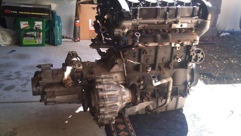

I used high temp "VHT wrinkle plus" black paint, got it from a local spares shop here. Saw a couple of UK cars with it so just had to do it! I know cable shift would be the go if you want to go for big hp but for now the TDi 020 gearbox will do. The K04-001 is the is almost the same as the K03s it just holds boost a bit longer. Will try to extract every last hp out of it!! Is that 249 whp?Originally posted by tommymac View PostYer man, i used a ACT clutch and its great, my 020 is OK touch wood and i just laid down 249 hp, nice paint man what did you use?

ah yer ok are they stronger? Mate an agu with a k04 is nothing to sneeze at in a mk1 you will smash things on a rolling start! Off the line its just FWD fail unless you have a LSD but then you will need a 02a and 100mm axles as you will start crunching stuff. To be fair with the k03 the car has a feel nice feel and was great, no its raw as hell but still great. You will love it mateOriginally posted by dubsquad View PostTommy, mine is from an early mk3 TDI which uses the smaller input shaft with bigger bearing (same as Loon's Scirocco) but with the longer gears i might have to add a dose of N20 to get through them quicker!!90 GTI Mk2 1.8t soon to be with GT28rs
The TDI gearboxes are made to handle alot more torque than the normal petrol 020's, the one i'm using got the 100mm axles. For this gearbox i'll just buy an ARP diff bolt kit and leave the LSD for when i change to Cable shift.Originally posted by tommymac View Postah yer ok are they stronger? Mate an agu with a k04 is nothing to sneeze at in a mk1 you will smash things on a rolling start! Off the line its just FWD fail unless you have a LSD but then you will need a 02a and 100mm axles as you will start crunching stuff. To be fair with the k03 the car has a feel nice feel and was great, no its raw as hell but still great. You will love it mate

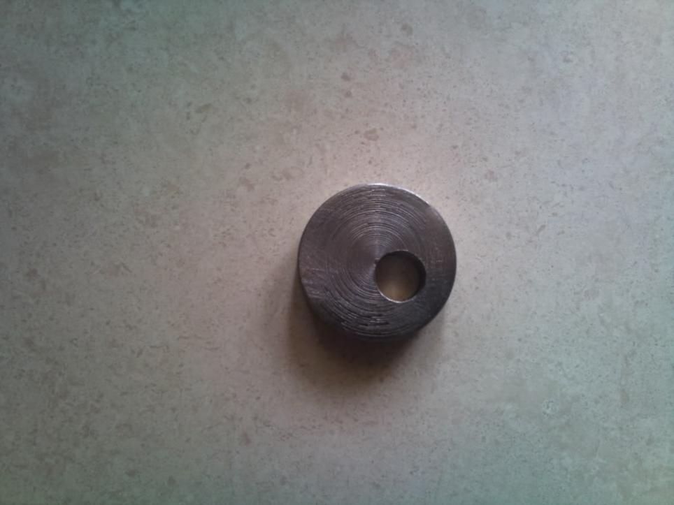

Finally got someone to make a spacer for the tensioner.

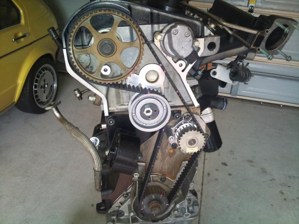

Tensioner fitted with new timing belt.

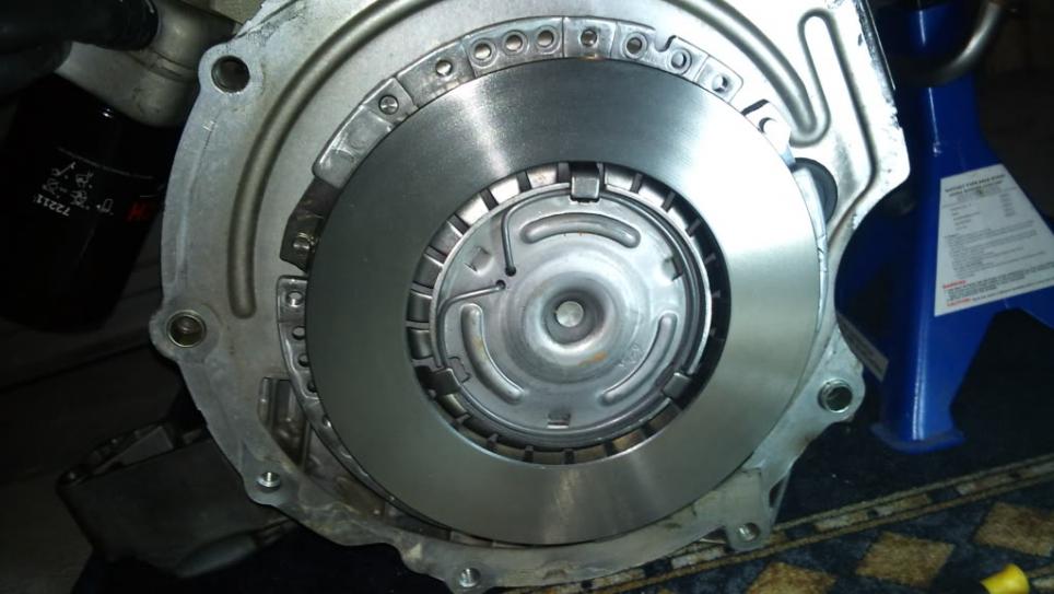

OK, did some work last couple days. Changed the release bearing and input shaft seals on the gearbox. The small seal inside the shaft was a b**** to get out!
The pressure plate bolted on...

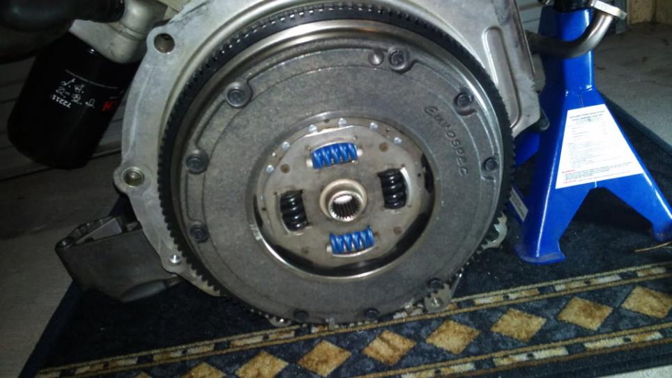

Clutch aligned and eurospec flywheel torque'd up...
