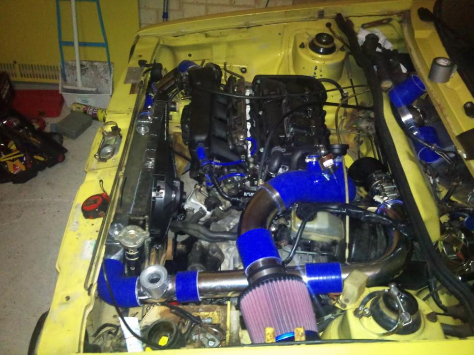

    Update: The new fuel tank is fitted, wiring loom plugged in, intercooler and radiator mounted.
    Will add pictures when I get back into town and hopefully get enough time off to get it done.

              Ok Gents, started the bad boy late last night. Idling straight and loud as f**k!!! Started 1st time as well. It was a huge relief to hear it run.
              Will postup a video tomorrow.
              Few issues - Small water leak by the housing to the cylinder head (will get new O-ring tomorrow)
              Rev counter not working (will contact qpeng)
              Oil light stays on (faulty switch maybe?)
              Now the real troubleshooting starts.

                Water leak is fixed, waiting for new oil pressure switch. Tacho still not working...yet.
