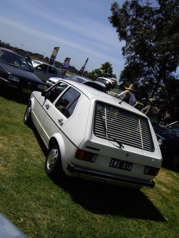

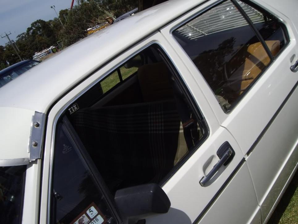

          The car has had a quick make over earlier this week & these pics were taken from the "Day of the VW" i
          I basically made the car as visually stock as I could, except for the sunvisor, roof aerial (even though it doesn't have a radio!) lowered, & large exhaust tip!
          Very sedate & the best sleeper! haha
          Also fitted a bench seat too! Not many people noticed it, but when they did, they loved it!
