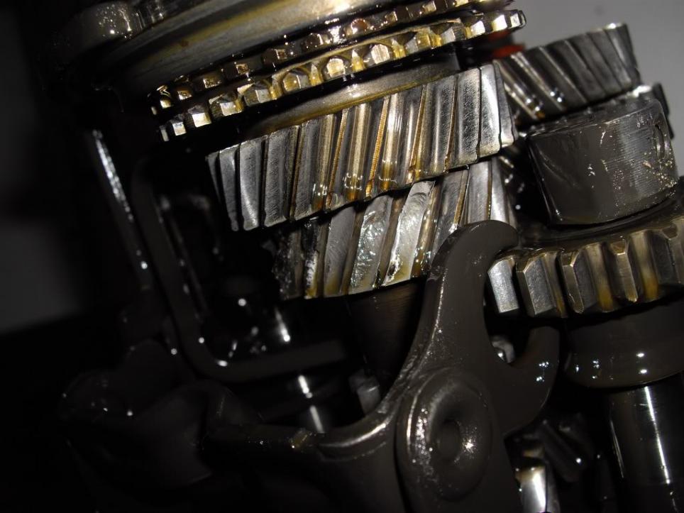

Well I finally got enough motivation to get out into the shed & carry out what I thought would be a straight gearbox swap.
Not too be.

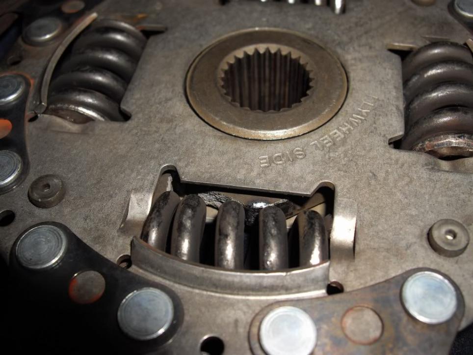

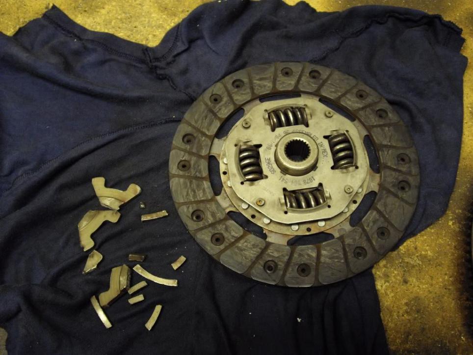

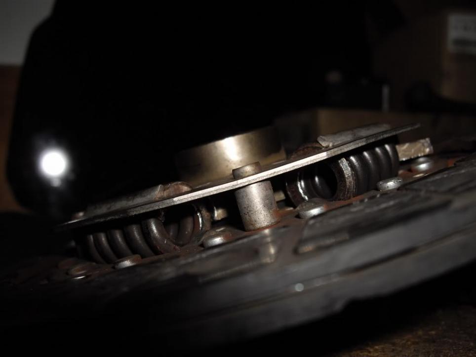

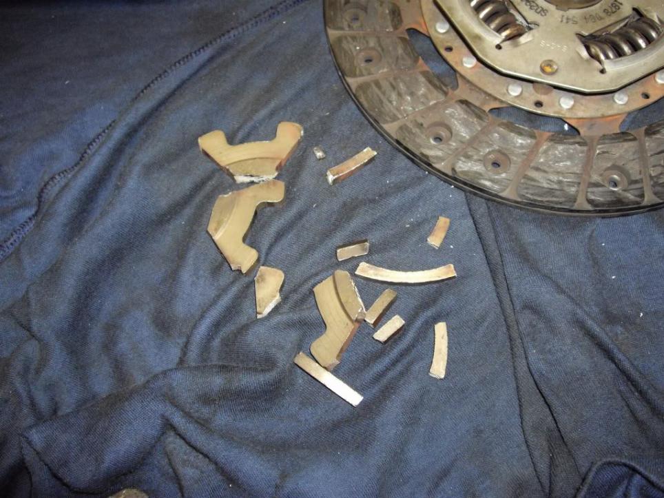

Once I removed the gearbox, I found bits & pieces of metal fragments inside the bellhousing & scratch marks all around the flywheel!
So off with the clutch & with a light I also found not only did I destroy the gearbox, I also destroyed the clutch drive plate!!!!!!
On with the pics

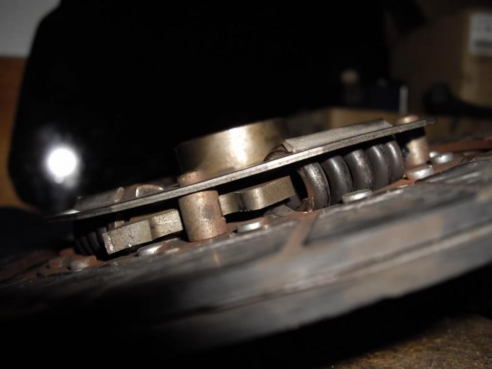

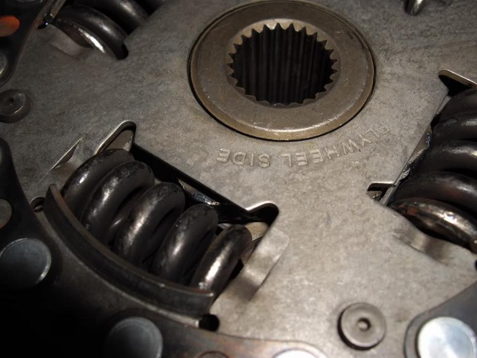

Think of your clutch plate drives your gearbox input shaft & from friction material drive section (outer section) is drives through a set of dampening springs & onto a metal star shaped item which then drives the input shaft.
Well I smashed up the metal star drive plate & nearly stripped out the dampening springs out of the housing too!

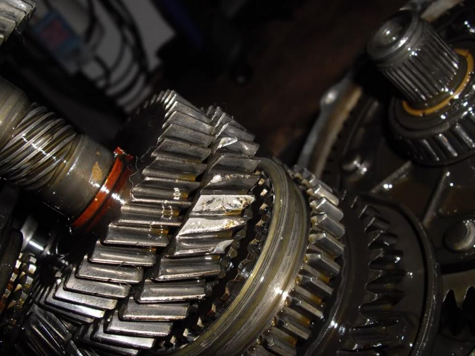

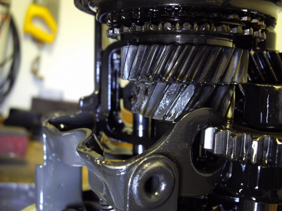

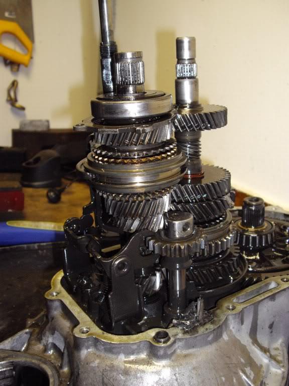

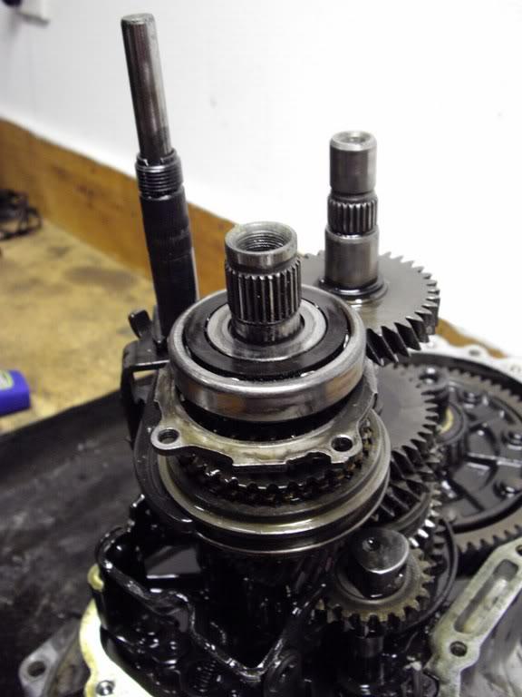

So after having a bit of a "what the f$#k do I do now?" moment, I moved onto stripping the gearbox to have a "captain cook"
What I found was no great surprise to me by the sounds the old gearbox was making but...
It stripped both 2nd gear driver & driven gear & also mashed up the layshaft out support bearing!
So all in all, pretty much screwed! No signs of the diff rivets letting go or any other bearing marks from little metal fragments getting through the oil.

I've never seen a clutch let go like that. Not even reading through all the drag & horror stories on vortex!
This was also a HD Sachs clutch with the 3 drive tabbed pressure plate!
