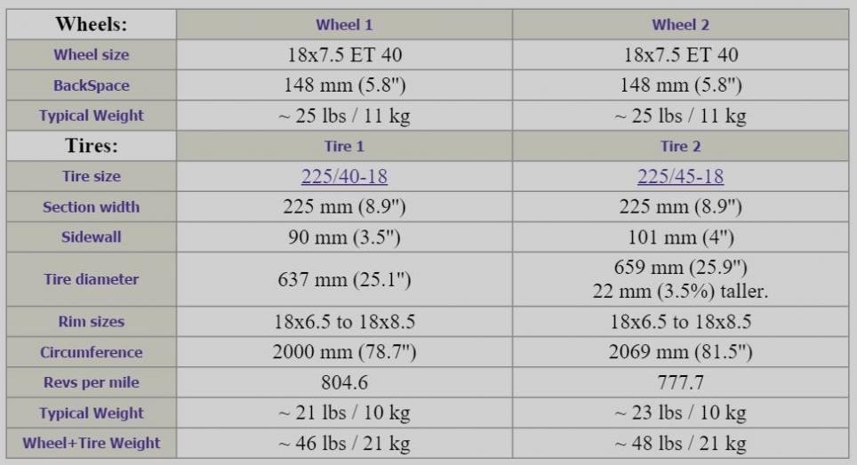

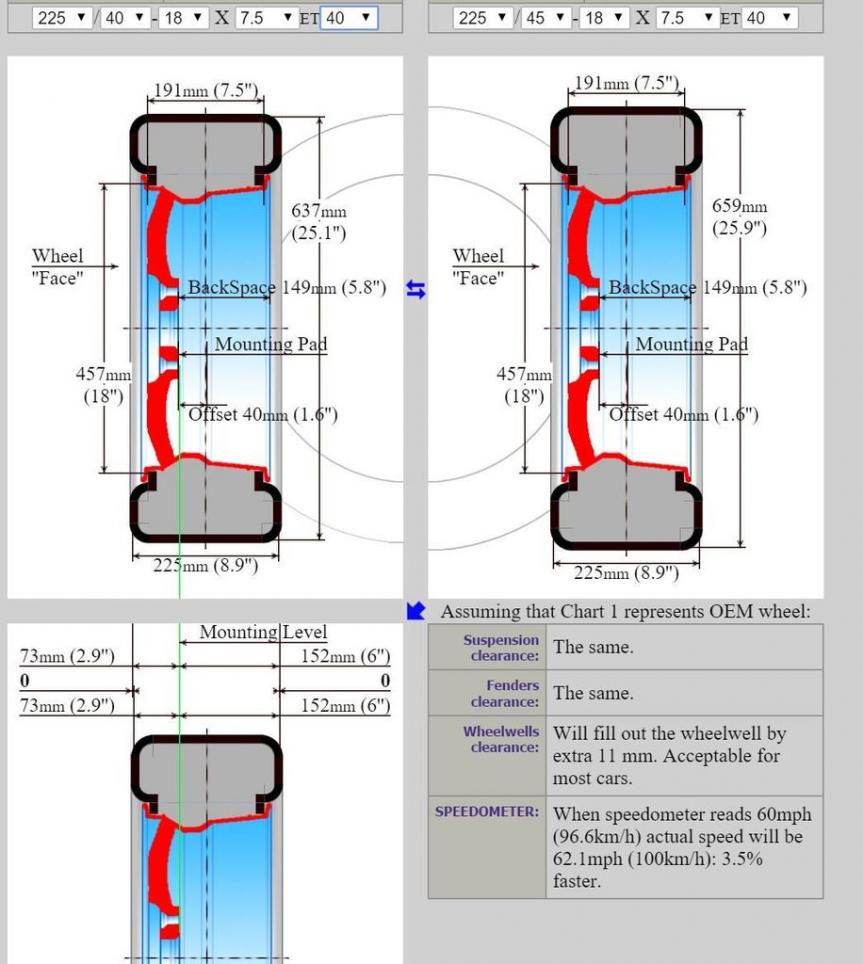

      This is a great place to see what changes with different wheel and tyre combos:
      Custom rims, wheel tire packages for your ride - RIMSnTIRES.com
      In your case it looks like this:
