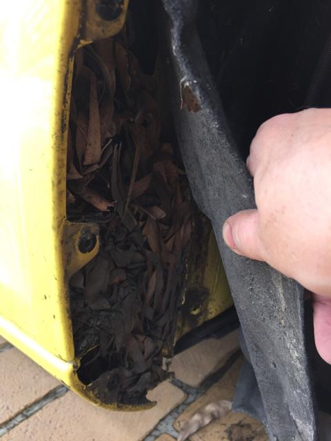

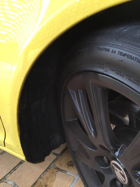

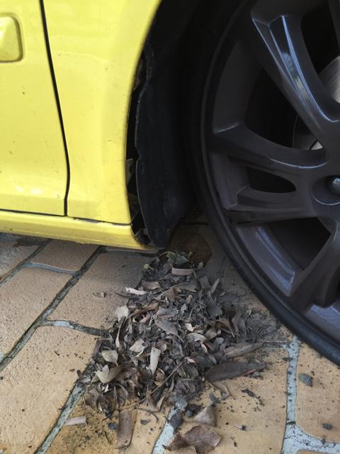

                          • I had found when washing the car that I was getting dribbles of dirty water from both sides, just behind the front wheel arches: I had suspicions that my car had sat outside for an extended period prior to my ownership, as every time I washed it I was cleaning significant amounts of crud from all the boos and crannies: the gap under the rear glass, the side bump strips etc.
                            So yesterday I decided to loosen the inner front wheel arches and see why I'm dealing with:
                            It was the same on both sides: heaps of dirt and leaf litter: not sure if this is a common occurrence, but probably worth checking for those with 1z bodies- it takes a couple of minutes, and you only need to rove 4 screws on each side. It had obviously been there for a while: the dirt was caked on and took a fair amount of scrubbing to remove...

                            • Nice work mate - i had a similar level of crud in my Mk6 GTI front guards when i bought it 2nd hand. I spent the 1st week doing a full detail inside, outside, and under.
