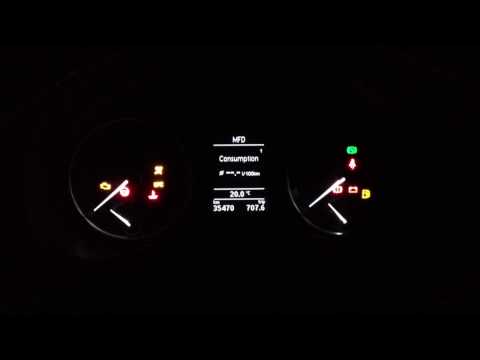

So I got the cable today and loaded up VCDS... Turns out Skoda Australia customer care and their "technical department" know jack all about their own cars, not only did my 118 have the cabling and the globes (as stated in my earlier post) but after about 10 minutes inside VCDS I have now enabled the following quite easilyOriginally posted by roshea View PostCool! Interested to hear what you learn.
- Needle Staging (the sweep thing it does when you start the car) [17 Instruments / Adaptation 10 / select Staging from the dropdown]

Glad you worked it all out! VCDS is a handy tool to have, although chances are you have done all the tweaks you will every want already... from here on out it's for reading error codes
(and helping fellow your fellow VAG enthusiasts).
Sadly the staging doesn't work on the 118TSI Golf

yeah I haven't really looked through everything yet but I will. Interestingly when I did the staging it said it didn't know a particular code so can it just use a default 12345 and I said yes and it worked still.

It didn't work on my Golf either but I got it to work on a new Polo the other day
There are plenty of "things" the computer seems to know about but not all of them will work, best bet is to enable and test them one by one.
