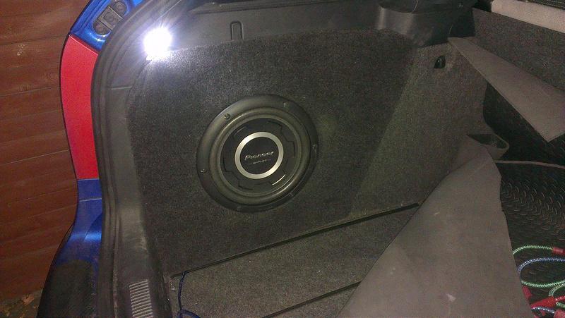

    • Originally posted by andymarc View Post
      I like that install too..

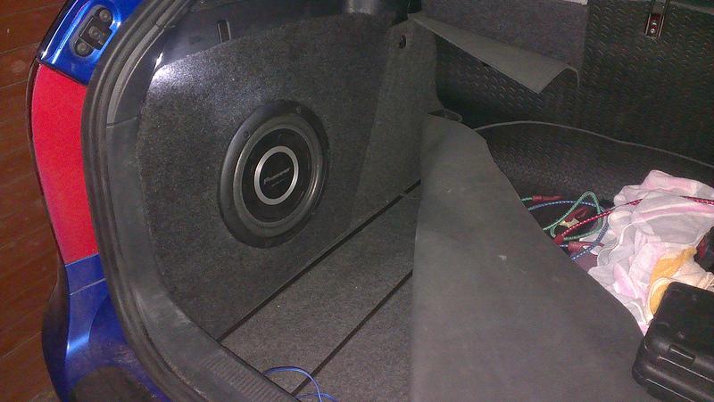

      Did you make a custom box or is the the sub mounted on a mdf carpeted panel?
      I have a 12" response sub at home from my old commodore which i have been meaning to put in (even bought hi quality H/L converters from the US) but havent yet due to being too lazy to make a custom box!
      I used the factory panel as a template to make an MDF panel with the hole for the speaker and the port. I just covered it with standard car carpet from bunnings.

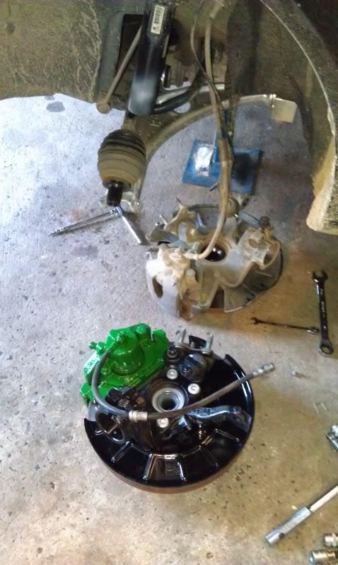

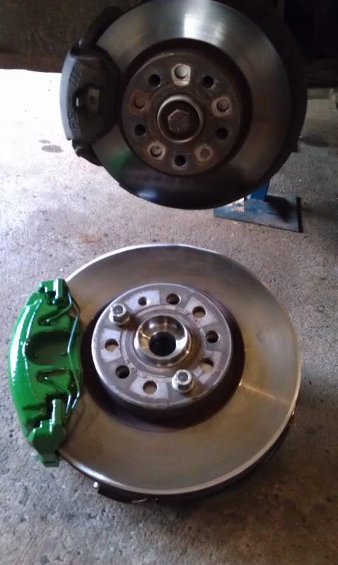

      • Almost got my GTI brakes in this weekend... until I realised that my car has 50mm struts in the front... could have sworn it was 55mm.
        Anyhoo, here are pics of the re-colour coded GTI brakes to suit the marque:
        Anyone else with base model octavias wanting to upgrade brakes - your parts list will look something like:
        > GTI/TFSI/VRS bearing carrier
        > """ caliper carriers and calipers
        > Set of four brake caliper carrier to beairng carrier bolts (you wont have these!)
        > Bearing kit is a good idea
        > new shocks/front struts with 55mm body's

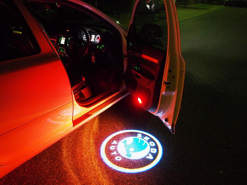

                Got a set of these sitting at home ready to go. Did you wire them in to the red door lights? If so, how did you physical wire them, which wires to which wires.
                Cheers,
                www.TheRapidWrench.Melbourne
                The convenient, professional and affordable mobile bicycle mechanic that comes to you!
                My RS build thread
                • Originally posted by MountainBikeMike View Post
                  Hey mate,
                  Cheers,
                  Hey!
                  I have these as well.
                  The red door lights have two wires, as do the projector lights.
                  If you have them set to the wrong polarity - they just won't light up, so you swap the wires over!
                  -Cheers
