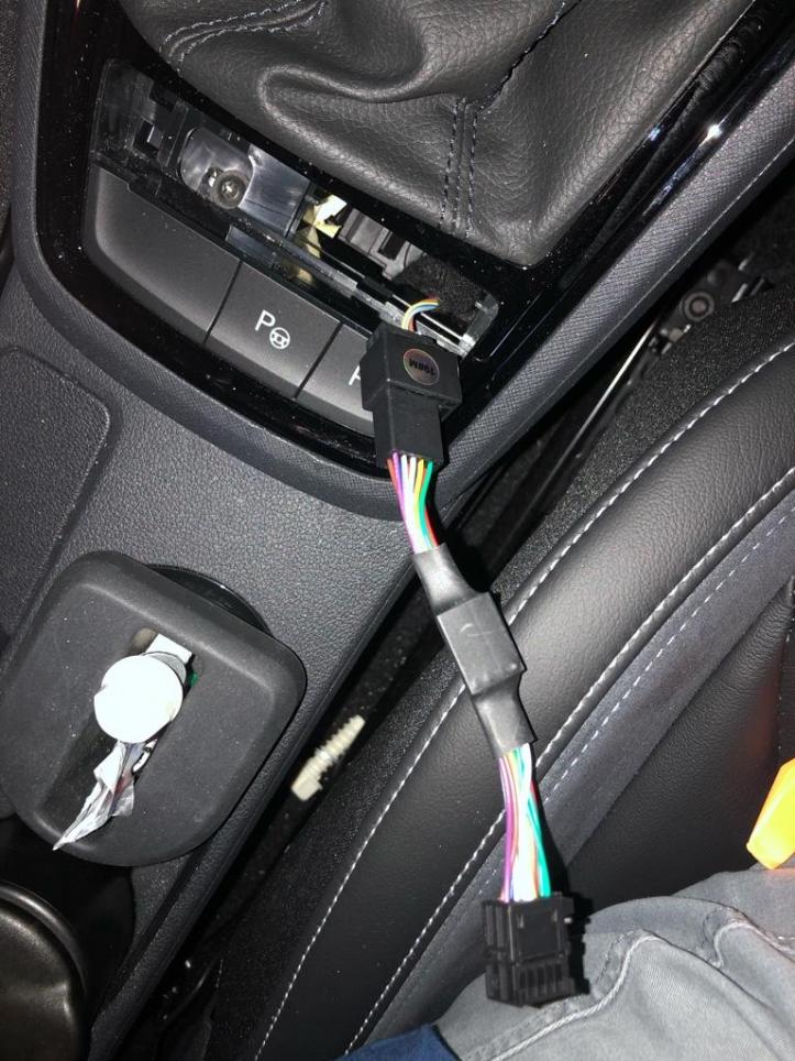

    Have you attempted to isolate stop/start via VCDs by any chance ?
    Thanks
      Yes and you cant only way is with the cheater cable from Aliexpress, which I have but havent been game to pull the console trim apart to fit it You can have it for the $50 it cost me and I have photos on how to remove the trim and switch

        Thanks. I’ll look into it. Im not too keen on adding hardware to achieve this mod at this stage.
          Its only a cable that you attach to the switch and to the connector you pull off the switch and it enables it to be turned of all the time or back to normal as you want. Its just bloody hard to get the trim off so you c
          an pull the bank of switches out to insert it.
          Mamba Ebike to replace Tiguan
            Thanks again. Im in no hurry, I’ll look into it
              It's the only way to achieve this since 2020 sometime. They killed off the software fixes.
              I got the cable and installed it in my mother's Kamiq.

                So how hard did you have to pull the trim to get it off I am reluctant to pull too hard even though a Russian guy sent me photos of him doing it

                      Yes and its impossible as VAG have disabled the ability to do it Only way is to buy a cheater cable from ALIEXPRESS and fit that However getting the console apart to get the switch out is really hard and I gave up Consequently have the cable sitting here $30 posted

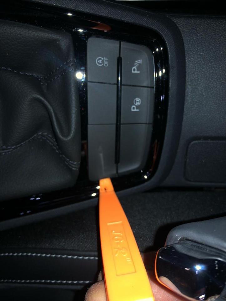

                        Hi, it was hard until a couple of kind gents on FB showed me !
                        Photos show it all

                          Hmm a Russian guy sent me pics and he removed the whole trim around the switches and gear lever and all so I thought it was too fragile to do that so left it. Might try it from these.
                            I would say it took me less than 5 minutes start to finish
                              That's easier than how I did it myself, but I got there.
                              Nothing is fragile, it's supposed to pull apart, it's just thing it with care that's the issue for our cars.
