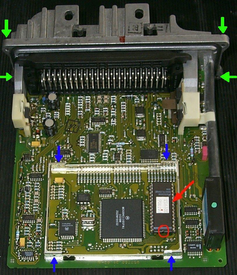

        Completed tonight. EPROM in and power delivery is so much better.

              Stock ECU socketed or do you have to desolder the original chip? Is the upgrade worth it on a stock ABF?

                They just push in. No soldering necessary.
                    Push in.
                    Yes. But there are so many other things these old engines need to have working properly before you get the full advantage. O2 sensor was the biggest gain in performance before the EPROM.
