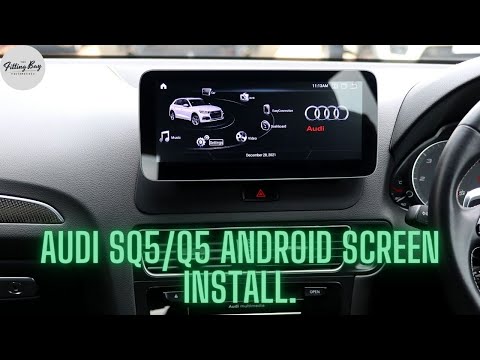

          At the time I was in the car a lot and found myself missing a decent interface with my phone through the MMI. I saw a youtube video from Auto Electronic Solutions (AES) in Melbourne fitting a 10.25” unit to an SQ5 in Melbourne and thought it looked really cool. Turned out that particular SQ5 was parked at an office around the corner from my office and I was driving past it every day but didn’t notice. I stopped at it one day and peered through the window at the unit and was impressed at how “OEM” the fitting looked, finished quite well.
          Got in touch with Nathan from AES, turns out we knew some of the same people. He has a lot of experience in fitting, and also spent some time working for one of the big name car audio suppliers.

          The Android Auto interface as part of the unit is great, makes music/maps/calls much easier. There was some initial teething issues with my phone as it is dual sim and I don’t think it knew how to handle it – but a software update has fixed that and it’s been flawless since.
          I haven’t put a SIM in it, so can’t attest to how that works but I imagine it would be good. You can download other apps etc outside the Android Auto interface if you like. I’ve found this a huge usability improvement for me and the car.
          Android Auto is only available as wired, I’m led to believe Apple Carplay is wireless – would have been cool to be wireless, but what can you do. I’m lazy and still have the USB cord coming out of the glovebox to plug into my phone, on my list is to go back to Nathan for him to run the USB into one of the existing ports in the centre armrest console.

                Can you please confirm if this is the kit you bought? A4/A5/Q5 (09-16) 10.25" Android Replacement Screen. – The Fitting Bay
                I wonder if they have any recommended install partners in Newcastle or at least Sydney. Electronics are one aspect of cars that I do not enjoy, so I would want to have this professionally installed.
                  Yep, that's the unit.
                  I hear what you're saying about using the OEM screen for full OEM look - I have a colleague with the same car as mine that went down that route prior to me installing. Once he saw my install, I think he regretted it. From what I hear, MMI wheel for Android Auto/Apple Carplay interface just doesn't feel right!
                  I recall RSNAV or Aliexpress had a touchscreen unit that is larger than OEM but not by much. It uses it's own fascia kit, but fits in effectively the same space that the current screen occupies (ie doesn't stick up the way my screen does). Could be a good half-way option.
                  Install is an issue. Two enquiries I'm making for you. I've texted Nathan just now to ask if he has any contacts up your way. I've also texted a colleague that will be able to tell me whether Autobarn Warners Bay or Heatherbrae have audio fitters on staff at the moment. Provided they do, I imagine they can do the job - with Nathan's youtube video being so good, it's pretty easy for a half decent fitter to follow along. I'll post again when I hear back.
                  Here is Nathan's video of the SQ5 install, that's the car I was creepily looking through the windows of. Toward the back end of the video you can see the touchscreen and interface in action.
