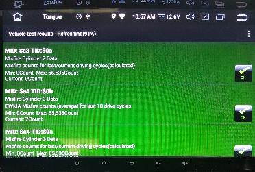

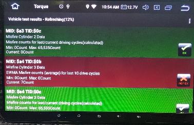

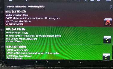

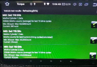

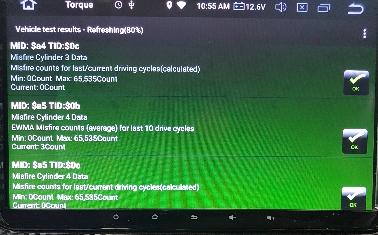

                          Can someone enlighten me test shows O2 sensors fail and surprisingly Cylinder 1 test failed too
                          Test report:
                          MID:$01 TID:$83
                          - O2 Bank 1 Sensor 1
                          Max: 1.92888 Min: 1.99046
                          Test result value: 0.81462
                          FAIL
                          MID:$02 TID:$81
                          - O2 Bank 1 Sensor 2
                          Max: 0.64514V Min: 0.6549V
                          Test result value: 0.63538V
                          FAIL
                          MID:$21 TID:$84
                          - Catalyst Monitor Bank 1
                          Max: 65,535 Min: 4,096
                          Test result value: 7,830
                          PASS
                          MID:$35 TID:$81
                          Max: 11° Min: 21°
                          Test result value: 21°
                          FAIL
                          MID:$3d TID:$8b
                          - EVAP Monitor (0.020")
                          Test incomplete or dependant test failed
                          MID:$41 TID:$85
                          - O2 Heater Monitor Bank 1 - Sensor 1
                          Max: 1,302.80005°C Min: 759.90002°C
                          Test result value: 819.79999°C
                          PASS
                          MID:$42 TID:$81
                          - O2 Heater Monitor Bank 1 - Sensor 2
                          Max: 1,568Ohm Min: 0Ohm
                          Test result value: 144Ohm
                          PASS
                          MID:$a2 TID:$0b
                          EWMA Misfire counts (average) for last 10 drive cycles - Misfire Cylinder 1 Data
                          Max: 0Count Min: 34Count
                          Test result value: 27Count
                          FAIL
                          MID:$a3 TID:$0b
                          EWMA Misfire counts (average) for last 10 drive cycles - Misfire Cylinder 2 Data
                          Max: 65,535Count Min: 0Count
                          Test result value: 3Count
                          PASS
                          MID:$a3 TID:$0c
                          Misfire counts for last/current driving cycles(calculated) - Misfire Cylinder 2 Data
                          Test result value: 11Count
                          PASS
                          MID:$a4 TID:$0b
                          EWMA Misfire counts (average) for last 10 drive cycles - Misfire Cylinder 3 Data
                          PASS
                          MID:$a4 TID:$0c
                          Misfire counts for last/current driving cycles(calculated) - Misfire Cylinder 3 Data
                          Test result value: 9Count
                          PASS
                          MID:$a5 TID:$0b
                          EWMA Misfire counts (average) for last 10 drive cycles - Misfire Cylinder 4 Data
                          Test result value: 2Count
                          PASS
                          MID:$a5 TID:$0c
                          Misfire counts for last/current driving cycles(calculated) - Misfire Cylinder 4 Data
                          Test result value: 5Count
                          PASS
                          End of report.
                          Sent from my SM-G935F using Tapatalk
                            Are you getting these results from Torque Pro or OBD Fusion? It's a different set of results I've not seen before. Do you have a screen shot of what you're running?
                              Attached is a screenshot of 2 identical misfire reports one at first scan and the other after the app refreshed.
                              it's strange torque shows cylinder 1 not ok at first then when refreshed the next one shows ok but with the same misfire counts.
