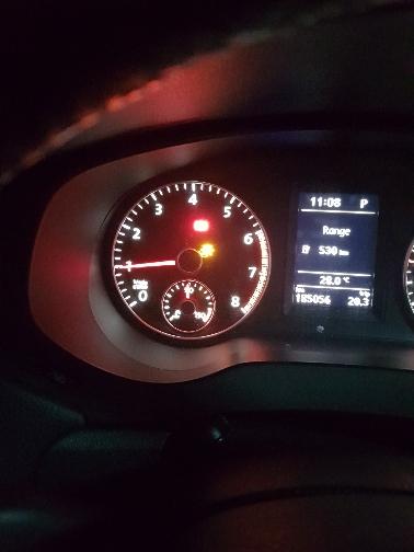

                    Hi all
                    I finally got around to service my Jetta mk6 as for the misfires it could be down to the Chinese made obd 2 that I've been using as the garage still can't detect misfires.
                    That being said there a new problem that just popped up right after servicing the car, it idles high at P position abt 1000rpm like as though you're still stepping on the throttle I tried a light tap on the throttle and it went back to normal 745rpm.
                    Could it be a faulty throttle sensor? It feels like the throttle is stuck and upon tapping on kinda releases it.
                    Not sure what to make of the problem.
                    Manage to get a video of it will try to attach to this post.http://cloud.tapatalk.com/s/5ef0de00...622_230826.mp4
                    Sent from my SM-G935F using Tapatalk
                    • #25
                      I believe it will run richer and noisier on startup until it warms up, although clearly not the case here as it's 28C and the engine appears warm.
                      Revs will also sit higher if the AC is on (does that change things?).
                      PS. Fix the bulb.

                        hahahahaha Hi Hawk yea the change blub indicator has flashed for some weeks now, would need to change that this time round.
                        You've describing the way my car starts up (first start or cold start) yes that's normal, but the problem I'm describing here is an unusual one happens after the running the car and once parked the rpm sorts of notch up a little and maintains at 1000 rpm doesn't go down to normal levels ie 730 ish unless I tap on the pedal a few times. It's due back to garage next week will update you as to the outcome.
                        Jumping to other topic here I found that the abs esc lights have come on too which the garage indicates the wheel sensors are faulty so gonna get that change too. Here I'm asking if the abs sensor lights up obd2 is supposed to pick up the fault right? ....Mine doesn't sigh
