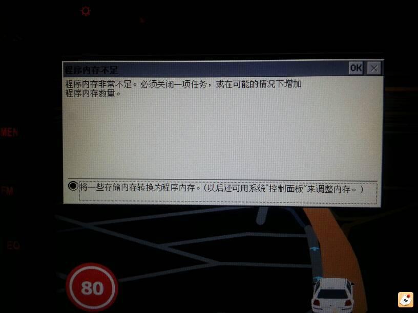

                  • So I had a new error tonight:
                    I was driving along with music playing from the SD card with the Nav up on the screen on just the map when this came up. The unit completely froze and I had to turn the ignition off/on to clear it.
                    May be something to do with the SD decoding issues Sandy mentioned although he would have to translate the error box for me!
                    Im running the latest firmware revision which I successfully flashed this afternoon.

                      • Originally posted by Goobz View Post
                        Interesting error. It basically says memory is critically low, which should not happen at all with 512MB of RAM unless there is a memory leak in the SD playback. Were you playing FLAC or a very large file, perhaps?
