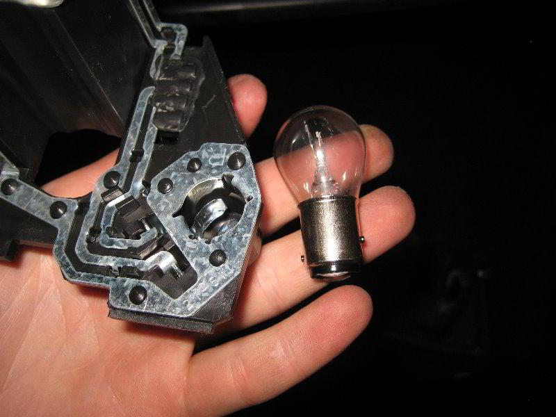

I am replying to my own comment as I just today realised I have made an error , what I thought was the brake light tail light was something else . Now off to see if the aftermarkets have this one . If they do I will edit the original to remove reference to the bulbs and add another problem .!
Also known as BAY12D 12V 21/5W Brake and tail light. Available aftermarket:
SCA Automotive Globe - Stop/Tail, 12V, 21/5W, 2 Pack - Supercheap Auto Australia

There are a myriad of those offset pin lights. Our Skoda has about 12 different ones in each socket, all different. Was really hard to fnd them as only Osram made them. I ended up shipping a bulk pack over from Germany and splitting it with a mate who has a Skoda.
Old Fords, Holdens and Toyotas use offset pins for a very good reason.
Its so that in dual filament lens you put them in the right way. EG in brake lights one is a 6w circuit for taillights and a 21w circuit for the brake lights.
Some idiots obviously dont know that and jam them in the wrong way as witnessed by very bright tail lights and very dim driver2021 Kamiq LE 110 , Moon White, BV cameras F & B

Offset pins on stop/tail globes were pretty well universal in the old days.Originally posted by Hillbilly View PostOld Fords, Holdens and Toyotas use offset pins for a very good reason.
I remember the time my stepdaughter's (then) boyfriend did exactly that to her Hyundai Excel. Sometime after he replaced the globe, I noticed the tail light was very bright, went to check it and found the tail light housing was partly melted and distorted from the excess heat generated by the 21w side of the globe being on constantly at night instead of the 6w side.

Well yes and no the offset is not from the bottom to the glass but side to side they are not on the exact opposite side as you would expect , if you look from the bottom one pin is dead centre of the outer diameter but the other is not equal in position on the other side . Here you can see the offset , now this where I made a mistake it was a brake bulb that was blown but the bulb I removed was the taillight only . I will stand by the first comment seems a bit dumb .

Er. Aren't the offset pin globes just double filament globes? Single filament will have a straight pin arrangement.
