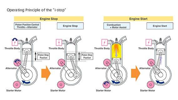

              • Originally posted by alexaescht View Post
                Once it's up to operating temp. I think it can start the engine almost completely without using the starter motor. It actually stops the crankshaft at a certain position so that it can then inject fuel into the combustion chamber of a certain cylinder that's in the right place and then it only needs to spin the engine a tiny amount to get it going again.
                I think I read that somewhere
                I seriously doubt that you can stop the crankshaft in a specific position. The normal idle speed is around 900 rpm. It would be close to impossible to stop the engine so that a particular piston was at a particular point in the stroke. On top of that, with a traffic light sequence about 3 minutes, the combustion chamber would have difficulty maintaining the compression temperature for that length of time. Even with the glow plugs fired up I doubt that you could inject fuel into one cylinder and expect the engine to turn over.
                Do you have a link to this?
                • DSG woes in The Age
                  This is Mazda's i-Stop system, but if I remember correctly VW use a similar thing (although I could be wrong)
                  Mazda's innovative i-stop engine-idling-stop system has won yet another award, this time at the lchimura Industrial Awards. While idling stop systems are now becoming commonplace due to the approximate 10% fuel savings they offer, conventional engine stop systems rely on a motor to restart the…
                  As you can see, it is possible to control where the crankshaft ends up when the engine is shut down.
