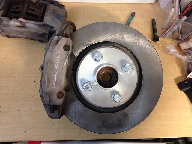

    Brakes.

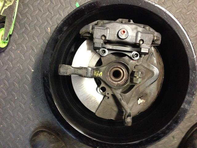

    I realised if I was going to do this, I'd need to upgrade the brakes.

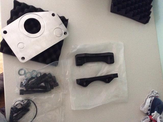

    After some research, I ended up with Porsche boxster Brembos and a kit from epytec to mount it to mk3 hubs (which will have the splines altered to O2M).
    These will fit (just) inside the 15x7 Oz Racing Rally wheels I bought and refurbed.
    Those are Corrado rotors - I want to keep 4x100 narrow track on this project.
    I'll might paint these but it will be the same murky grey that Porsche did... however given they'll be hidden behind those OZ wheels, I can't really see the point.
    If a tree falls in the woods and no one is there, will anyone but me know about my painted brakes? No.
    Below are the brackets from Epytec and their 2wd conversion kit for the gearbox.
    Just need to replace the internal seal and get a new cup for the modified axle to mount to.

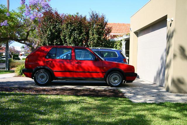

    Since this old girl doesn't lock up properly (but I've got the new handles and locks for the whole car here ready to go - which will bring me down to one key instead of 3!), my R36 lives on the driveway and it gets the garage... it is there sulking in the background of the pic below.
    I've bought a few ebay specials (like a new front lip) and the fitment has been really hit and miss, so I'm going to be relying on places like VwHeritage to keep this guy looking fresh. The wheel arches are entirely held on with tek screws (fencing screws?) at the moment and they stand out like dogs balls.Until I get around to replacing them with OEM rivets up front and black bolts at the rear I'm going to go with the mantra "if it ain't broke, don't fix it"... but I might give them a couple of jabs with an Artline.

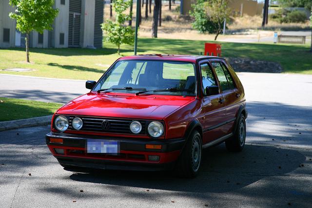

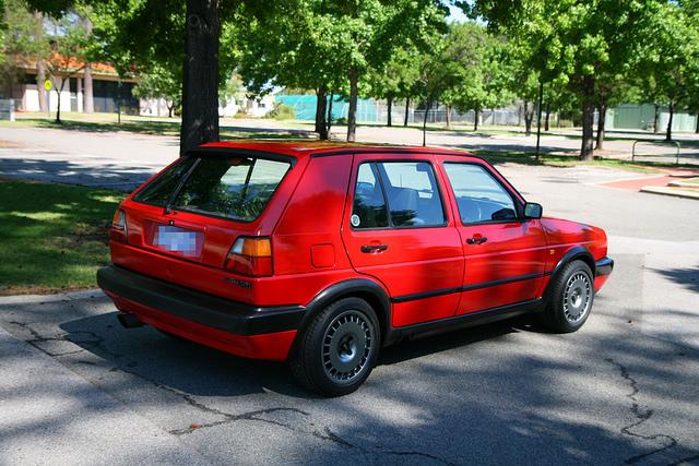

    Fast forward to now and I've been accumulating a lot of parts to clean up the exterior (new handles, skirts, badges etc) and gutted half of the dash to get at the heatercore... I get the impression the whole dash will probably need to come out for that. Which will mean the whole dash will probably end up flocked as it is cracked.
    Pics below are from last weekend, after the paint has been sanded within (and sometimes WAY beyond and into primer) mm of its life, and then buffed to a somewhat shiny state. I've made that sound like it was a weekend job - it took me months to stay motivated when it was a flat satin texture. Even now its sorta shiny, there's still plenty of satin spots and the downside of it being shiny is you now REALLY notice how smacked about some of the panels are. Probably to be expected for a 24yo car though - I'm impressed by how some other components have held up so well.

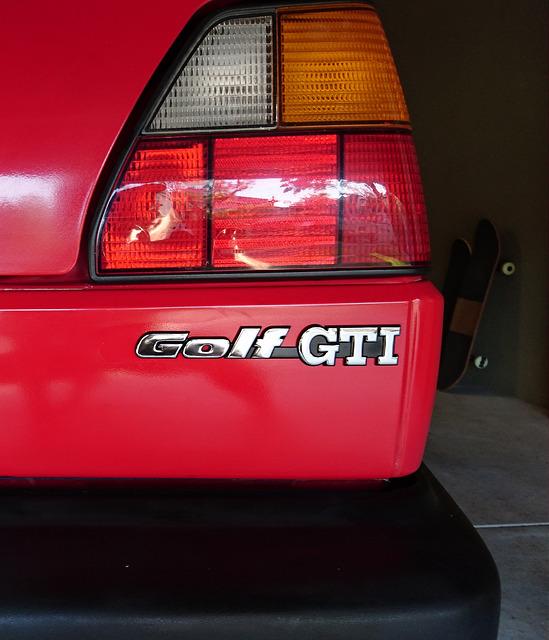

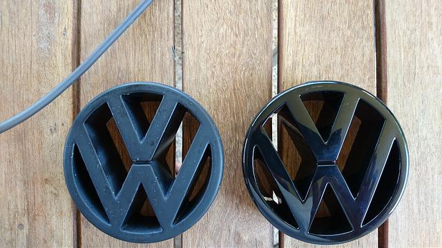

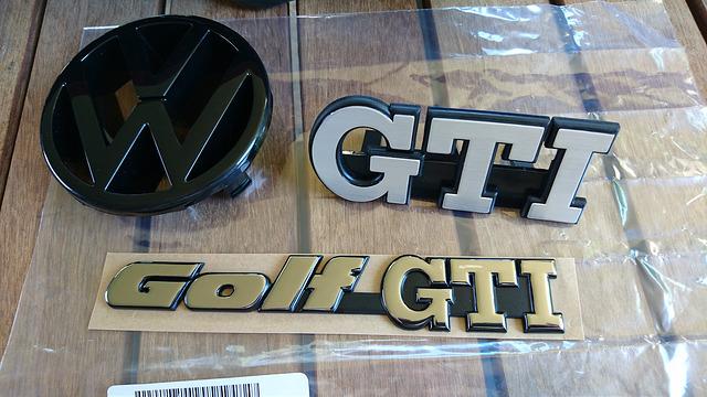

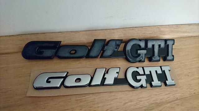

    Some new badges have freshened things up a bit further on the weekend:
    The size of the new rear badge is quite a bit less than the older one. I suspect thats a mk3 badge as its just stick-on too.
    It covered the holes left by the original though - that counts for now! I'll look into getting the original one refurbed.

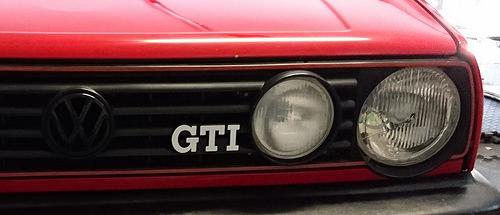

    The front end GTI badge is obscenely big compared to the proportions on current model cars.
    Imagine a badge the width of your headlight... not likely

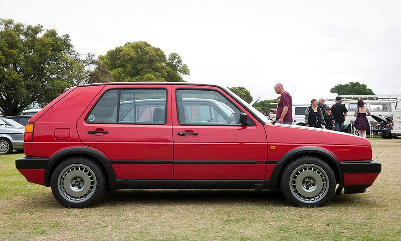

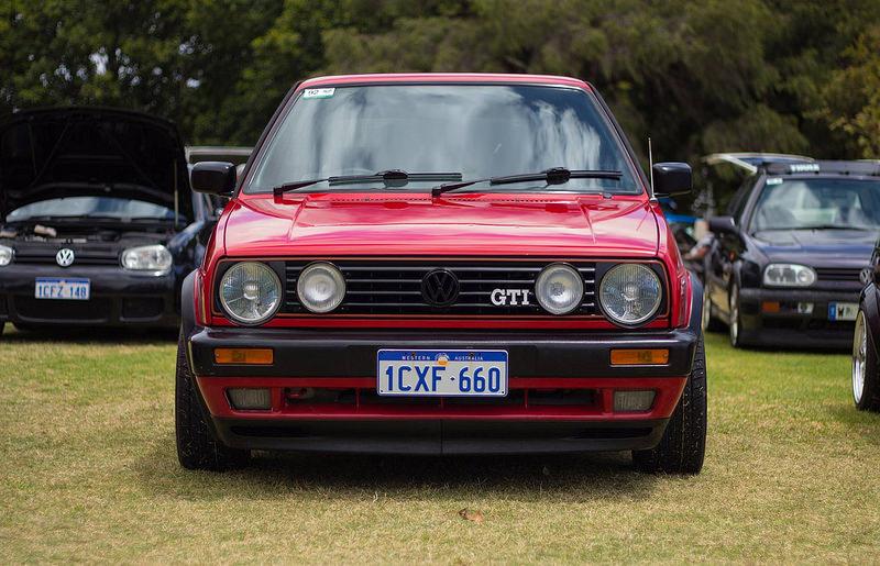

                      There were a few photos taken of it at DOVW here in WA - none of these were taken by me.
                      I grabbed them from Facebook (but have deleted my FB account this year) so can't tell you exactly who took them!
                      If you see your photo here and want your name attached, let me know.
