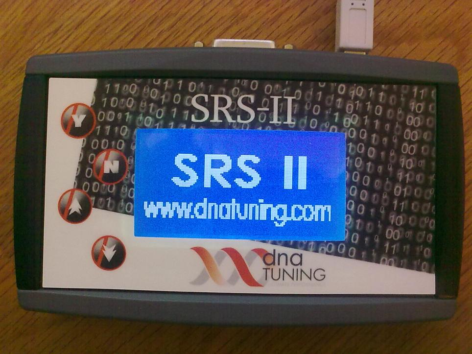

    DNA Tuning hand controller and dyno sheet

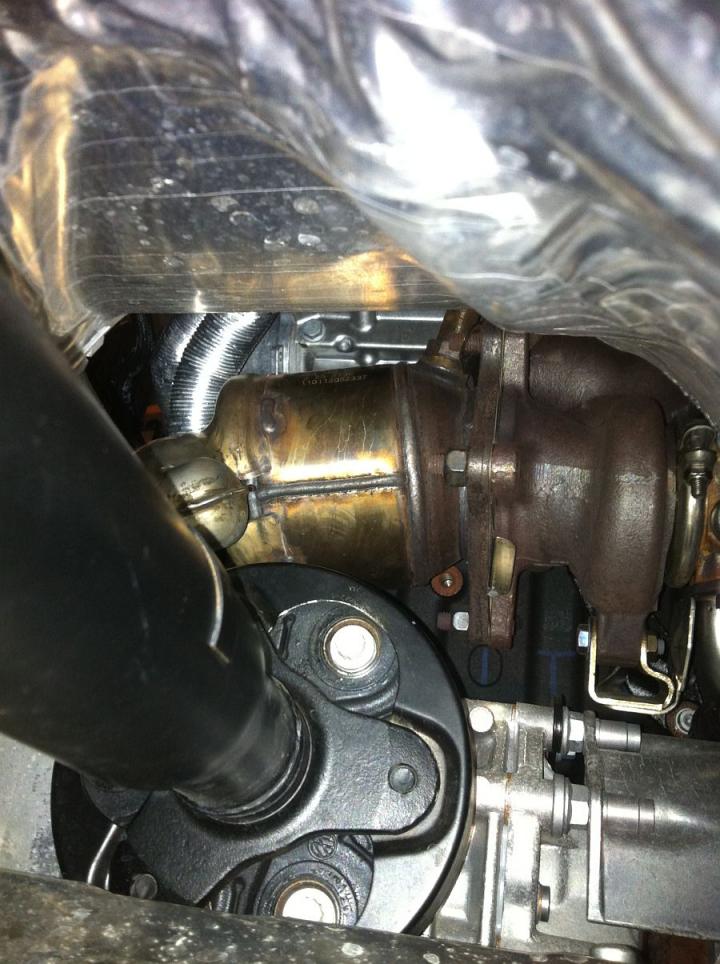

            Stock horrible restrictive dump pipe.
            New Scorpion 3inch dump pipe. (note tailshaft is still unbolted in these photos which is why the tailshaft is so close to the exhaust)
            What you can't see is that the back part of the dump pipe isn't on yet because Scorpion provided clamps that were too small to fit over the pipe. So ive had to get my local exhaust shop to order in some 3 inch clamps for me. I should get this finished tomorrow.
            PS - has anyone else realised that the tailshaft on the US spec Golf R's is different to the Aussie Golf R's?? Ours is pretty much the same diameter along the entire length and is smooth - their's varies in diameter (goes much smaller) and also has grooves (about 8 of them) along the length of the tailshaft....wonder if there is a reason for this?

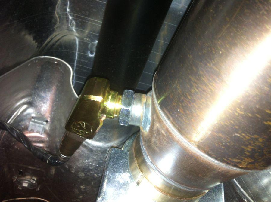

              42DD Oxygen Sensor spacer. Takes all of 2 mins to install once the cars up on stands. Will be nice to not have the CEL illuminated on the dash anymore:

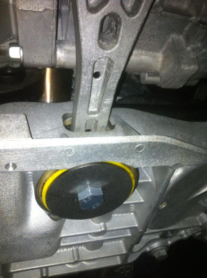

              The BFI 70 Duro Torque Arm Insert. I still maintain this was a right bugger to install, but as with most things, now that ive done it, it would be much easier if i ever had to do it again. Very interested to see how this feels now thats its installed - hopefully it will crispen up the shift and stop engine/gbox movement.

                            So how do you find the torque arm insert?
                            I had an APR one but it was a bit too harsh for my liking nad induced cabin vibrations at idle.
                              Originally posted by stotto View Post
                              Love it, just a tad jealous lol.
                              If we ever bump into each other ill take you for a spin. I think i've seen you once on Industrial Drive but you were going the other way.
                              I had an APR one but it was a bit too harsh for my liking and induced cabin vibrations at idle.
                              Good - i like it. Its only the softest 70 duro one, so i've noticed zero vibrations or any other negatives. Im not sure how hard the APR one is, but this particular one is to my liking. Some other people who have installed the 80 or 90 duro ones have complained about vibrations.
