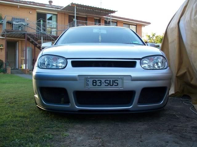

          So an update: Picked her up yesterday arvo from getting all the parts painted and it looks awesome. very very pleased and happy with it all. The guys at PJ Customs did an unreal job as usual. Still have to get and fit my hella celis headlights and get the new muffler fitted this week sometime but here are a few photos:
          Looks heaps better painted. I actually don't mind it.
          How does the front bumper bolt up. I mean factory ones bolt up to the radiator support behind the grille but your grille appears to be part of the bumper. Am I missing something?

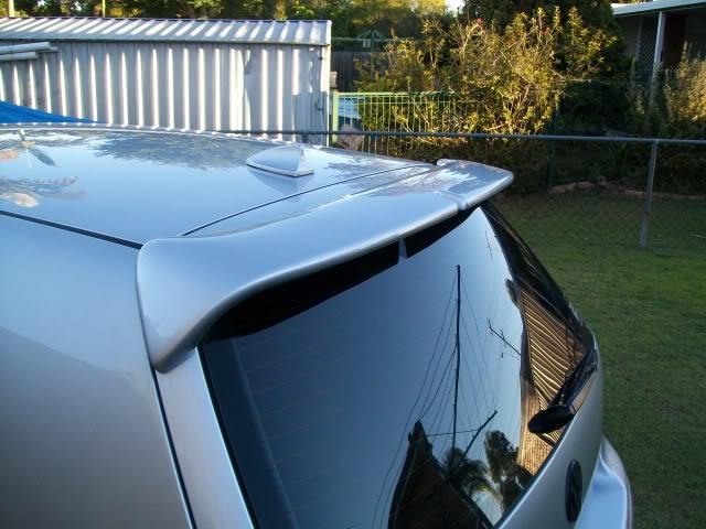

          Is the shark fin functional or a dummy?
          I think spacers would enhance the kit some more.
          Good work for doing something different!

                    shark fin is functional. As for the front bumper bolts into where the original bumper did ill get a photo to give you a look

                        • the wheels will be staying as is for a while now unless i come across something that really catches my eye and is in a decent price range. this is how it will be staying for now after the new headlights come

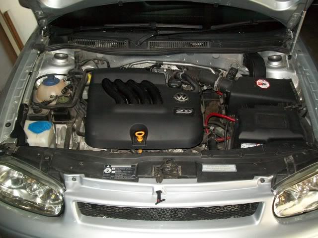

                            • for those who wanted to know the front bumper is mounted like this where the grill used to be
                              • Originally posted by 83_SUS View Post
                                Okay, so you don't actually use the 3 other original holes at the base of a factory grille.
                                So instead of 7 bolts, you use 4.
                                I reckon you could even out the gap between the bonnet and grille, but lifting your bumper reinforcement (reo) slightly on one side.
                                What I mean by this, is leave the screws that go between reo and radiator support (RS) and loosen 3 of the 4 larger bolts that hold the reo and lift on one side, then tighten.
                                Will lift the entire RS and enable better line up with your new bumper.
                                Not sure if you knew this already but the uneven gap was something I noticed.
                                Looking very sweet, can't wait to see future progress!
