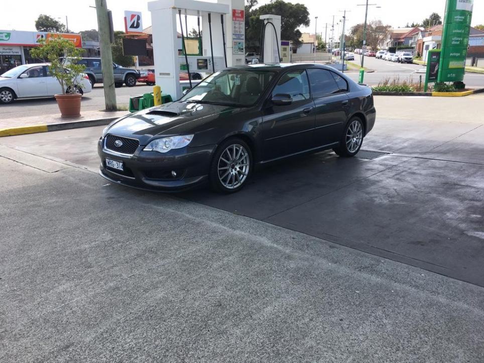

    After owning several VAG cars (Mk6 R and Mk6 GTI) over the past decade, and recently selling my Lexus IS-F, I decided to buy a brand that I have always liked but never owned before.
    We have the Audi SQ5 for the main car and family duties, so all I needed was a toy I could tinker with. I set myself a budget of $20k and jumped on Carsales. I did consider a large number of cars, but ultimately I needed something with some level of practicality, so it was down to a 4 door hatch or sedan.
    Fast forward a month or so later and welcome to the 2008 Subaru Liberty GT tuned by STI - a car i have always liked ever since they were first released. Found a one owner 2008 model which was in very good original condition and low km's. Full Subaru service history and no accident damage so hopefully it will turn out to be a good car to own for a few years. The original owner was well into his 50's and loves his cars so it's been well cared for.
    I have always been interested in owning a turbo Subaru to see what they are like....so here goes.
    Obviously the normal Subaru Liberty GT is very popular and on the roads everywhere, but this one is a little different in that its a factory 'tuned by STI' version which has the following additions as standard:
    - Only 250 made per year and each car is individually numbered (mine being #85 of 250 for the year 200
    - 18" STI Enkei rims
    - Bilstein B6 struts and STI lowering springs
    - Braided STI brake lines
    - Brembo calipers and larger disks (4 piston front and 2 piston rear)
    - STI front lip
    - STI rear spoiler
    - STI alcantara seats front and rear
    - STI 6 speed transmission
    - STI suspension arms (lower control arms, trailing arms etc)
    - An extra 10kw over the normal GT due to revised ECU tuning
    The engine is the EJ255 (2.5L 4 cyl turbo) which is the same engine as used in WRX of the same era.
