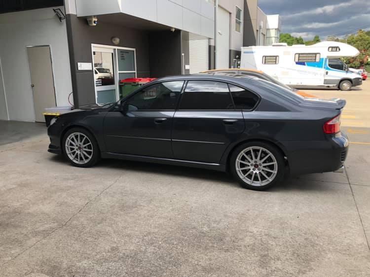

    Fast forward a month or so later and welcome to the 2008 Subaru Liberty GT tuned by STI - a car i have always liked ever since they were first released. Found a one owner 2008 model which was in very good original condition and low km's. Full Subaru service history and no accident damage so hopefully it will turn out to be a good car to own for a few years. The original owner was well into his 50's and loves his cars so it's been well cared for.
    I have always been interested in owning a turbo Subaru to see what they are like....so here goes.
    Obviously the normal Subaru Liberty GT is very popular and on the roads everywhere, but this one is a little different in that its a factory 'tuned by STI' version which has the following additions as standard:
    - Only 250 made per year and each car is individually numbered (mine being #85 of 250 for the year 200
    - 18" STI Enkei rims
    - Bilstein B6 struts and STI lowering springs
    - Braided STI brake lines
    - Brembo calipers and larger disks (4 piston front and 2 piston rear)
    - STI front lip
    - STI rear spoiler
    - STI alcantara seats front and rear
    - STI 6 speed transmission
    - STI suspension arms (lower control arms, trailing arms etc)
    - An extra 10kw over the normal GT due to revised ECU tuning

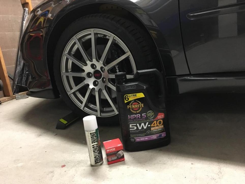

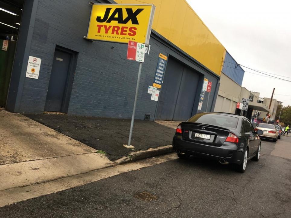

    As I purchased the car sign unseen from Melbourne, my 1st task was to get the car booked in for a blue slip so I could register it in NSW. It passed the blue slip with no issues thankfully.
    Next order was to give it a good service and a once over for any wear and tear, and to give it a detail inside and out (although it was very clean already).

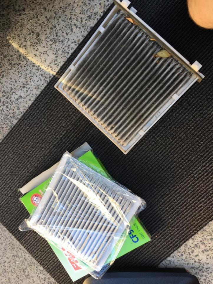

    Considering the car had full Subaru service history, i'd bet my left nut that the cabin filter was the original 12 year old one that came with the car - it was filthy. I actually removed the filter and cleaned it with the vacuum while I waited for a new one to come in the mail.

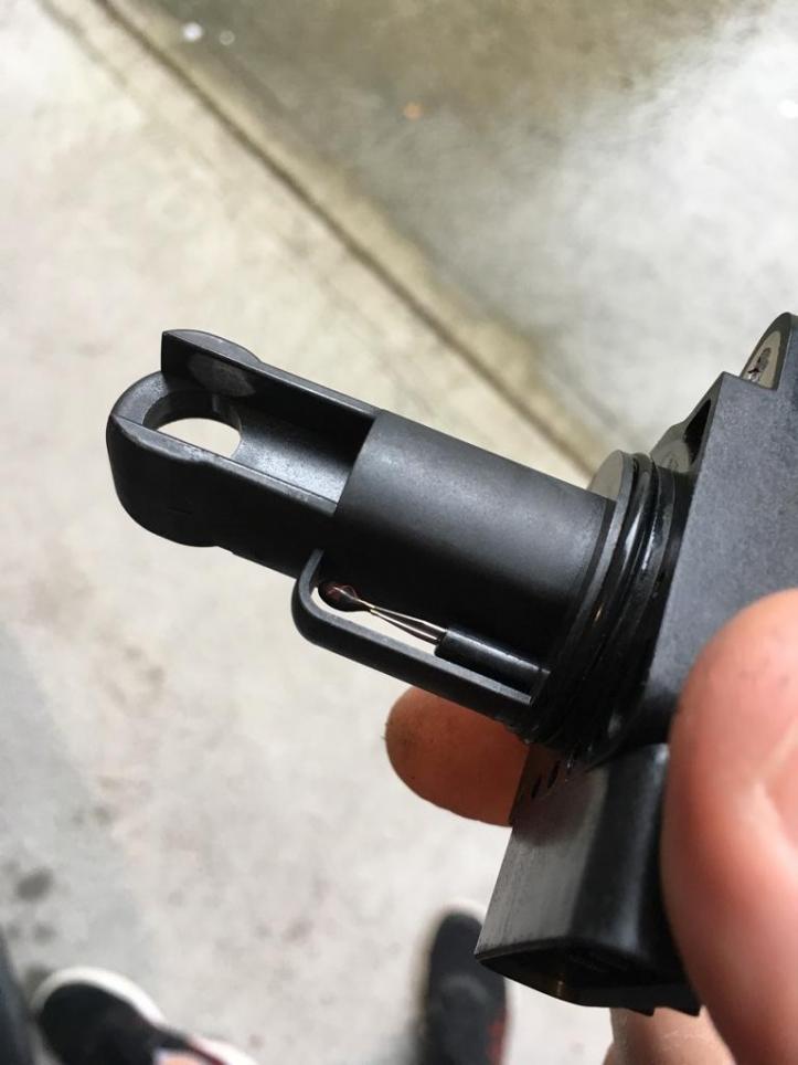

    The air flow meter was really grotty, so it got a liberal spray with CRC mass air flow cleaner and looked brand new afterwards.

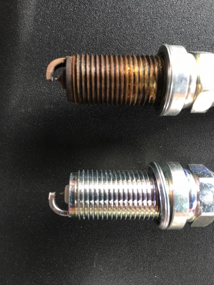

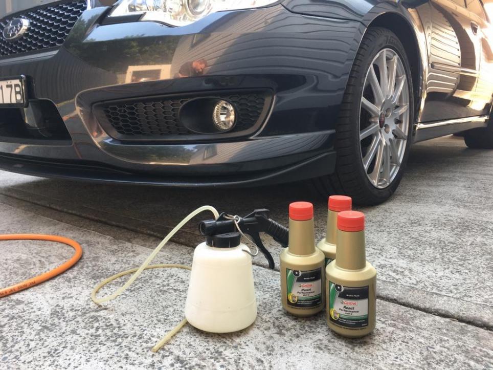

    The spark plugs appeared to be the originals too, so they were changed for good measure, and the brakes (and clutch) were flushed and bled with new fluid.

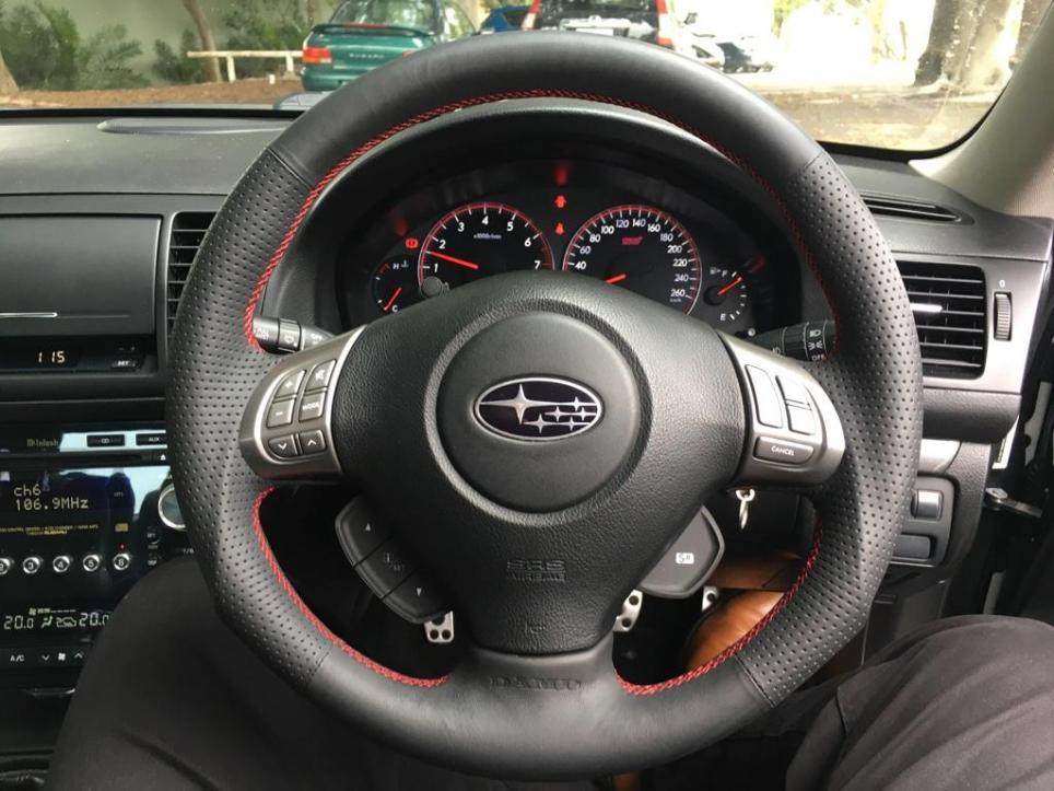

      New DAMD steering wheel fitted to replace the factory MOMO steering wheel (which was too thin and too large in diameter). New wheel is much nicer to hold, and smaller in overall diameter.

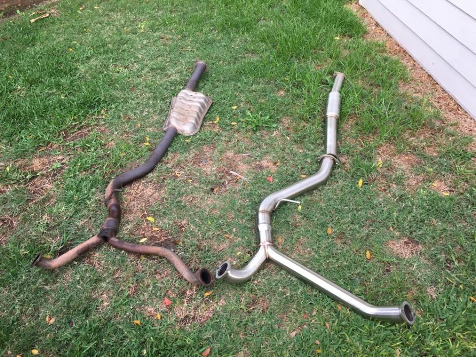

      And AVO Turbo catback exhaust to release some of that famous Subaru rumble. Sounds great and its a great quality exhaust. Forgot to take a pic of the rear mufflers but they are also from AVO.

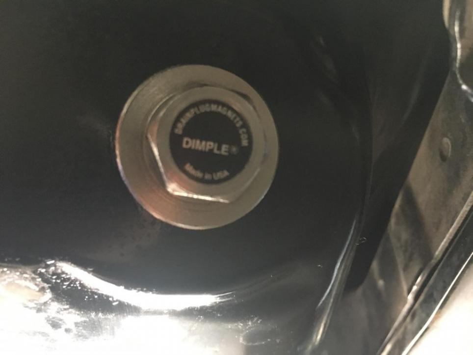

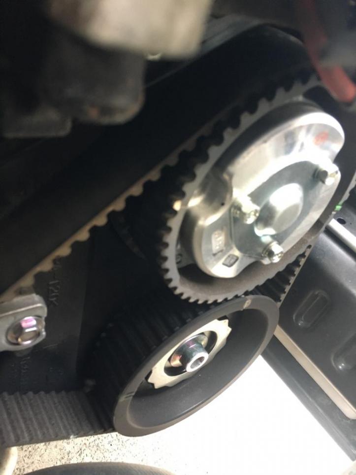

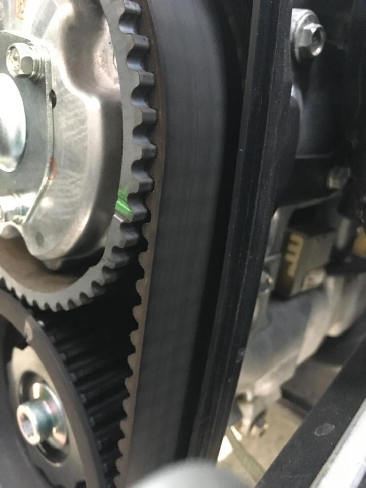

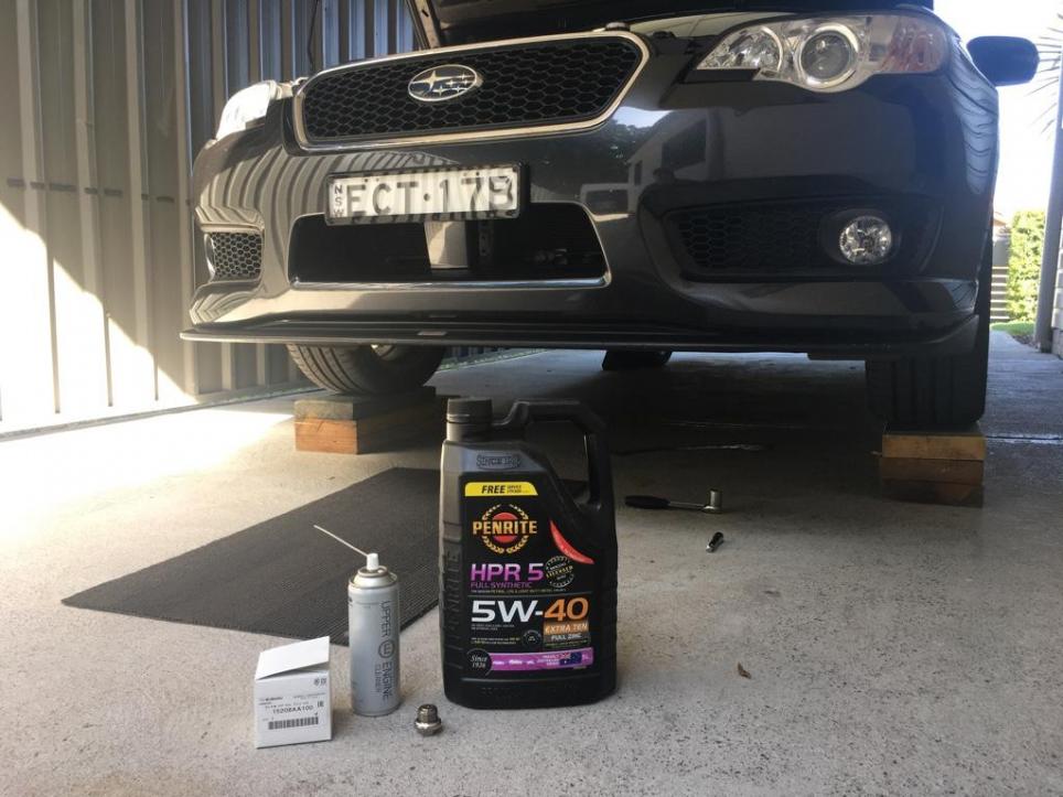

        Early March 2020 gave the car another basic service. The sump plug was butchered from previous owner/services (barely managed to get it off the first time I serviced the car) so knowing I needed a new one, I bought a high quality magnetic sump plug. Carbon clean, new oil filter and new oil.
        Also checked the timing belt as the car is 12 years old / 97,000km and despite having full Subaru service history, there is no mention of the timing belt ever having been changed. Thankfully it looks to be in good shape with no cracking or obvious wear, although I will likely change it within the next 12 months for piece of mind.

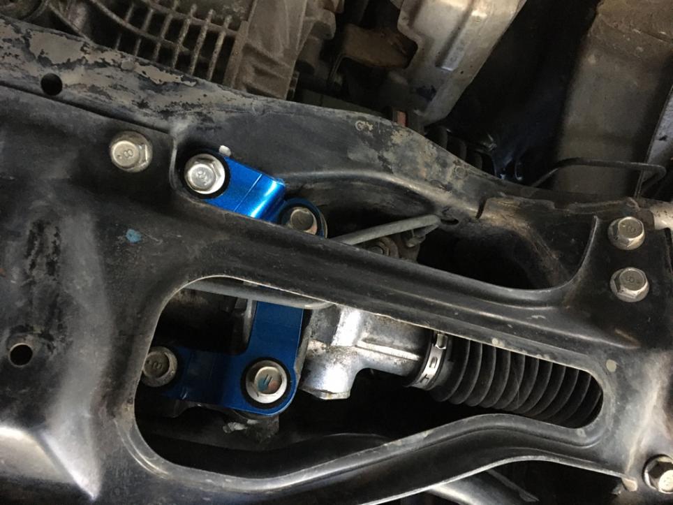

          Power steering pump and centre diff were replaced with rebuilt/reconditioned items shortly after I purchased the car. I knew about the power steering before I bought the car (quite common on these Liberty's to need power steering pumps replaced), but the centre diff was an expensive surprise and doesn't show itself unless you drive the car for a good 30 mins and get everything hot. Needless to say it didn't show up on a test drive and didn't show up when I had a mechanical inspection done because they only drive for a short period of time.
          Thankfully I found Corgiwerx in Sydney who specialise in rebuilding these parts, and offer an exchange program.
          So a good $1,500 later (parts and labour to install) I now have a quiet power steering system and a centre diff that doesnt bind when turning sharply.

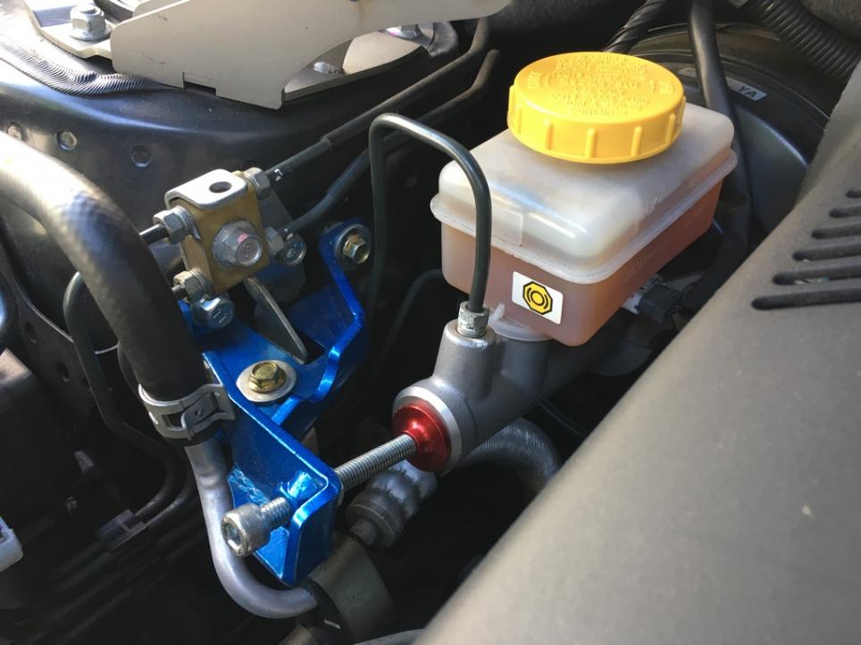

            Non VAG content...My 2008 Subaru Liberty GT (Tuned by STI)
            Some pics and JDM mods courtesy of Cusco and STI.

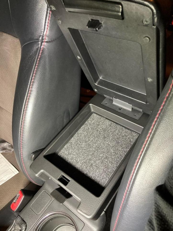

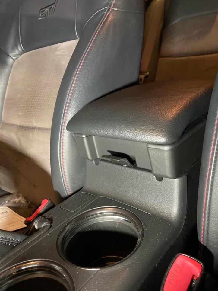

                    A little OEM+ mod for the Subaru courtesy of the JDM market. A new genuine Subaru armrest riser arrived yesterday from Japan. Took all of 2 minutes to install - fits perfectly as you would expect being OEM. Add's about 8cm to the height of the armrest.
                    Finally the useless (far too low) armrest can now actually be used to rest your arm on - who would have thought! Will be fitting a wireless phone charger in the top cubby as its the perfect spot for one.

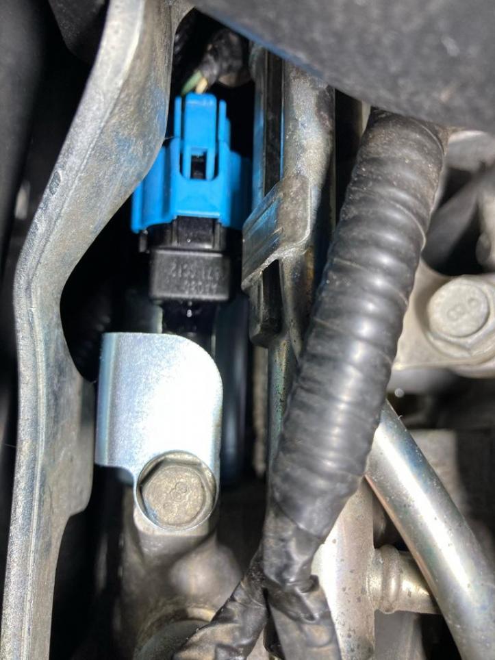

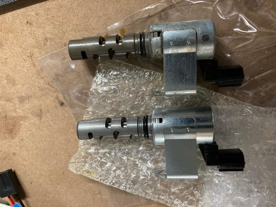

                      Also replaced the AVCS (Active Valve Control System) solenoids last week after diagnosing that they were the cause of an intermittent stutter I would get occasionally when driving the car. The AVCS solenoids are known to go on these engines between 80,000-100,000km.
                      New genuine parts sourced from Amayama in Japan for approx than 1/3rd of the local price. (local quoted price $280 each, Amayama price $104 each). Only took and hour to replace and stutter is now gone.
