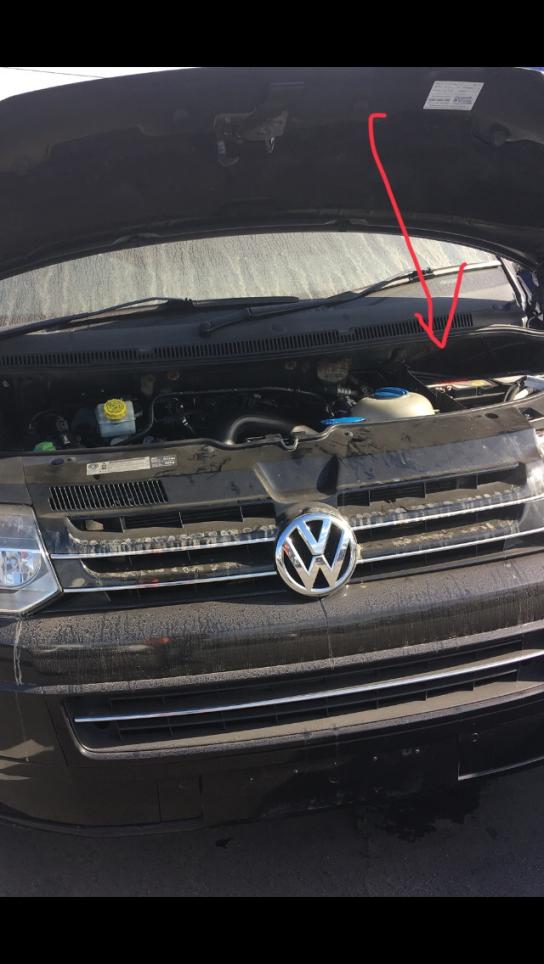

                        • #27
                          Has anyone changed the DSG filter on T5 multivan 2010 2.0 L tdi 132kw biturbo FWD . I assume it is located nearly directly above the drain plug . So its underneath the fuel filter somewhere.
                          Anyone have a procedure or know what has to be removed to change it. The Haynes manual does not have a procedure for this van.

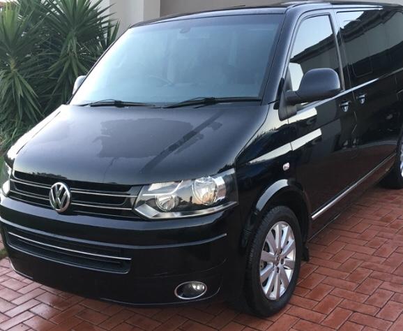

                            • #29
                              Originally posted by LogicprObe View Post
                              That van hasn't gone anywhere for some time..............by the look of it!
                              Looks a bit different now. Just needed a bit of a clean, and someone to look after it.
                              • #30
                                I spotted where the DSG filter is on the single turbo model and I would imagine its the same for both models , if you look over the back of the engine just to the left of the battery box you can see a large hex head nut thing which is the same as the engine oil filter cap . Not where your arrow is pointing further left .
