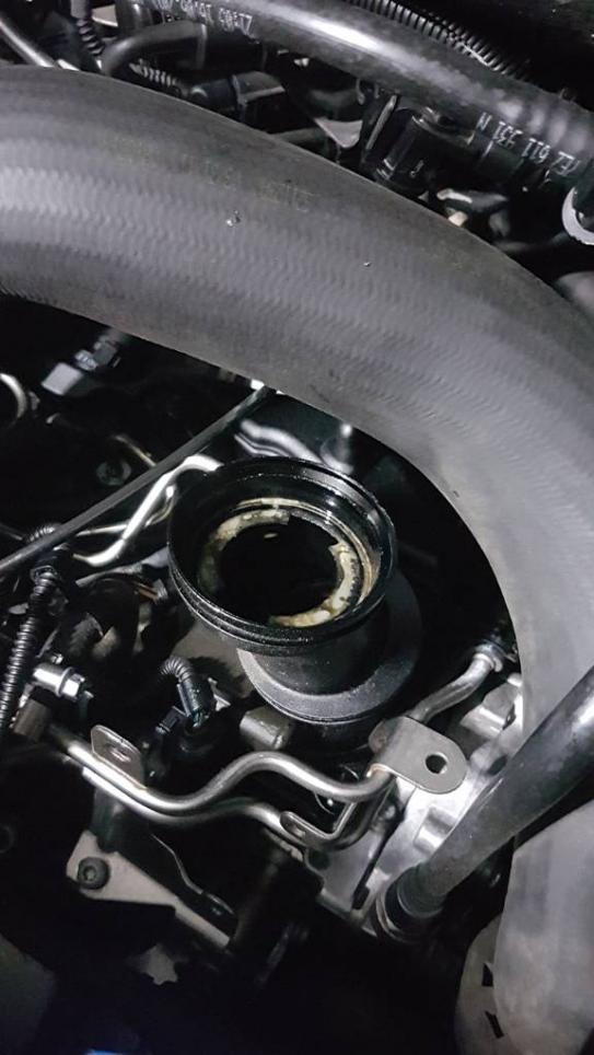

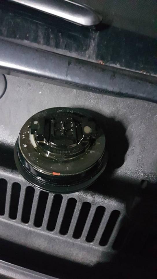

                                So now this happened. Drove from Bright to Sydney, topped up oil in bright to just under the full mark. Bright Sydney Canberra Sydney, oil is just above the low mark, coolant is under the min mark and coolant in the oil.
                                Off to find someone who can diagnose this. There goes the holidays...
                                Sent from my SM-G930F using Tapatalk
