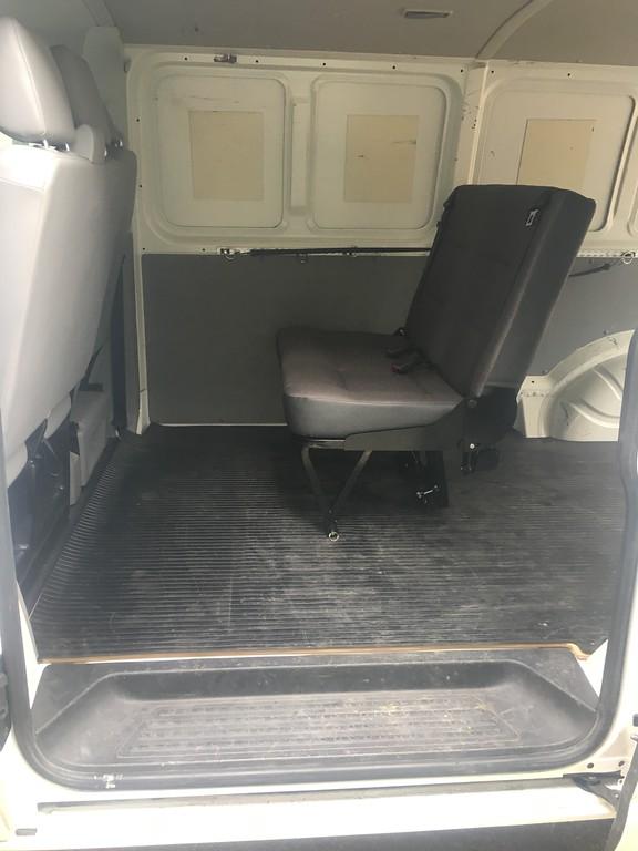

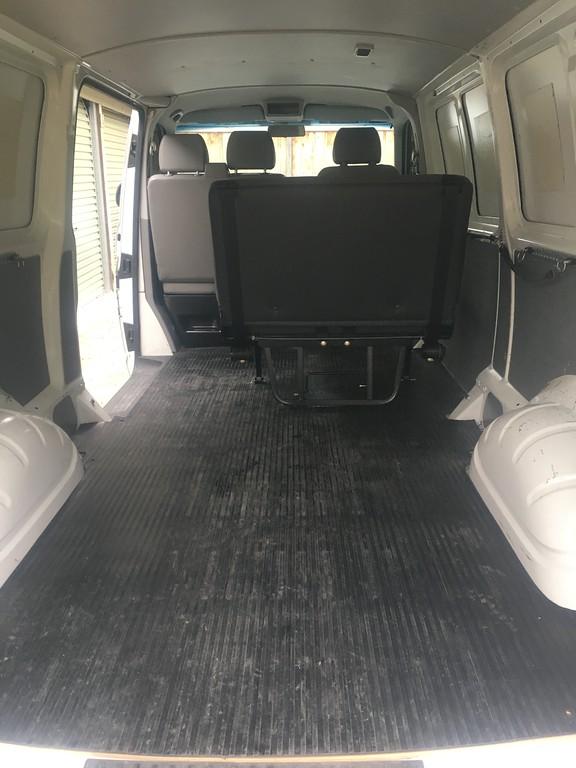

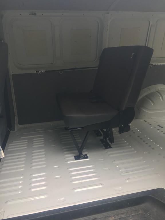

Added a small +1 about 8 weeks ago and therefore needed some extra seating so today I fitted a double foldable and removable rear seat, non genuine but approved for use in Aus, now just need to get it engineered. Wasn't cheap at $1500 but couldn't find any VW used ones. Installation was pretty straight forward but now I've gotta build out behind them to house all my tools and stock for work duties. Another project to put into the pipeline which includes the ability to go away
camping in it, so it has to be multi functional.

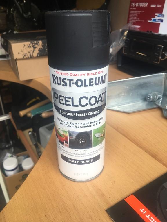

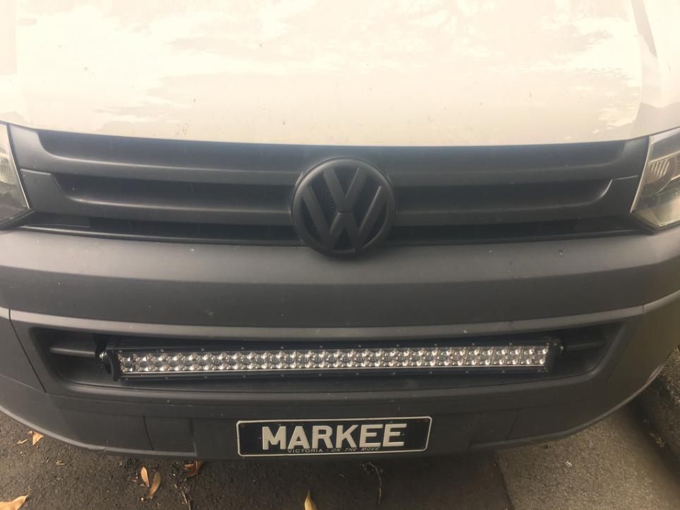

Sprayed my front VW badge just now and it turned out great.
Used this stuff which a friend had left over from using on the inside of his Storm Trooper helmet of all things!
5 coats so it's nice a thick and should put up with the abuse of being on the front of the van full time.
Just coming up with a plan on doing the rear ones now as I've seen the Transporter, 4Motion and TDI all done as well and they look great. Just gotta do some more research about it pealing off the surrounding painted body and not the actual badges.
I'm sure it's similar but it doesn't dry hard being a rubber finish. But I haven't used plastidip so don't really know.Originally posted by Foxpuppet View PostIs that plastidip?
