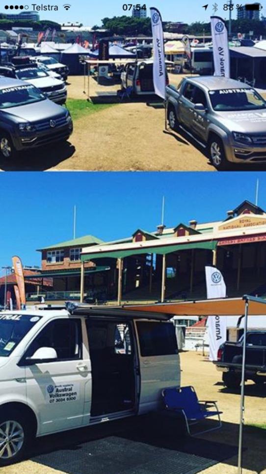

                            A photo from Austral of that show below

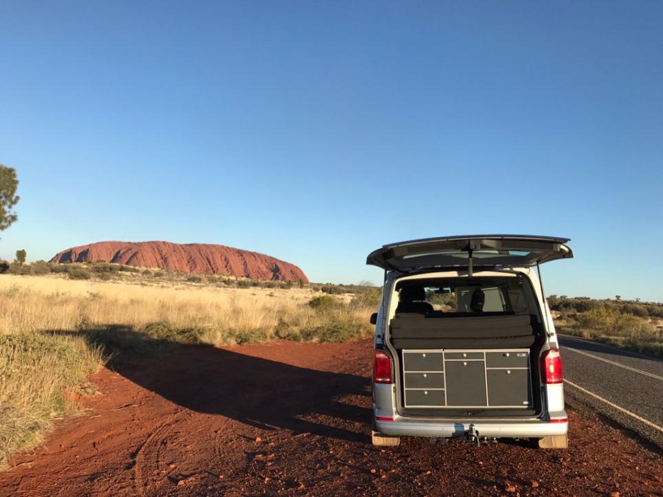

                              I have a Vanessa System fitted to my van and just did a Perth to Sydney return trip.
