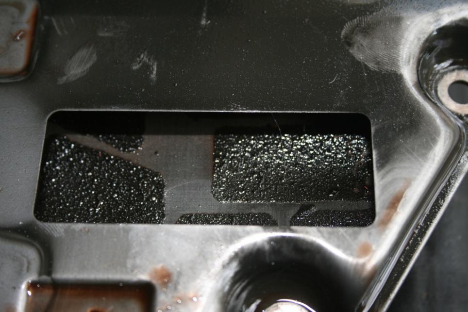

                  hi i have a t5 lwb 128kw with the dsg in it, ive only just bought it its got no issues with the box, but ive just pulled the the sump to change the transmission oil and cant find a replace filter, it looks the same as the one in the picture above from sunny. does anyone know where i can get hold of one, my local bullseye store cant find a listing for it either.
                    Are you sure its a DSG ? what year 128kw engines are the 5 pot job with Tiptronic , the Tiptronic has the filter inside the sump like mine . On the DSG the filter from reports is on the outside !! . Seems VW learnt from the early ones and put the filter where it could be accessed BUT from some reports YOU have to ask for the filter to be changed as someone reported its a bugger to replace due to placement in the engine bay .Someone correct me if I am wrong . I will still maintain that due to VW's engineers failure to recognise our climate extremes lack of fluid change will be the leading cause of some of its problems .

                        its a 2010,Im not a 100% sure its an DSG, but i cant find that filter listed anywhere for my van, the only one that comes close is on ecstuning.com
                        but there are for jetta, beetle, golf and passat which acording to that web site there are DSG, so thats why i figured mine was DSG. ryco listings are for RTK99 and RTK121 for 2010 transporter, but are not whats in it.
                          The 7 sped DSG in the Transporter is not the same as those in the Passat, Golf, Polo etc.
                          A decent VW parts department should be able to get this in for you. That is once they have got over their "sealed for life" brainwashing and actually looked into it.

                            Yes the passengers cars had DSG long before they fitted them to the Transporters , only Transporters were fitted with DSG around mid to late 2010 when the T5.1 upgrade was released . I think the dealers would have them as our local tranny place replaced ours at the rebuild time .Here is a selection on Ebay might be worth a look .ebay.com.au/sch/i.html?_nkw=vw+transporter+auto+transmission This is the part number but check first 09K 325 429, 09K325429
