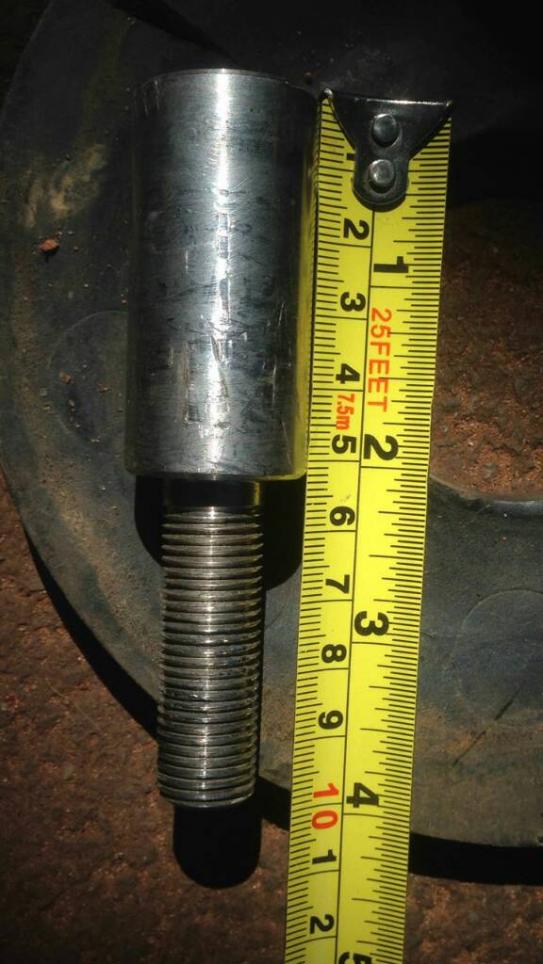

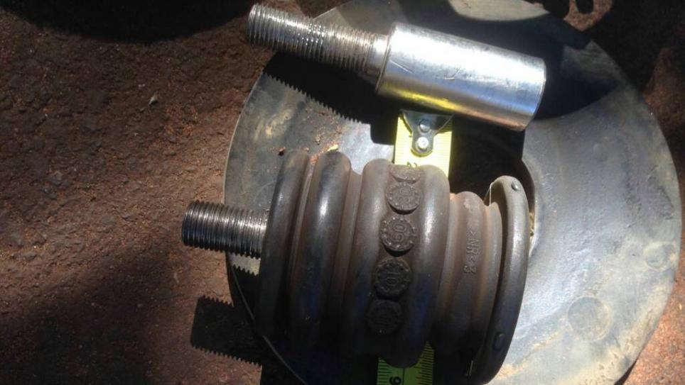

Hey Bryn I'm thinking they will settle a little but not that much. If they don't I'll be looking into some rear diff spacers to help with the increased rear drive shaft angle just to be on the safe side. In saying this does anyone know where to get the diff spacers from?

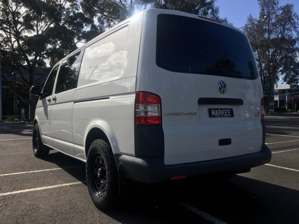

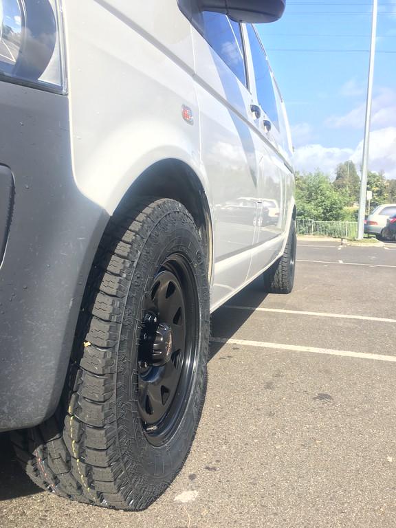

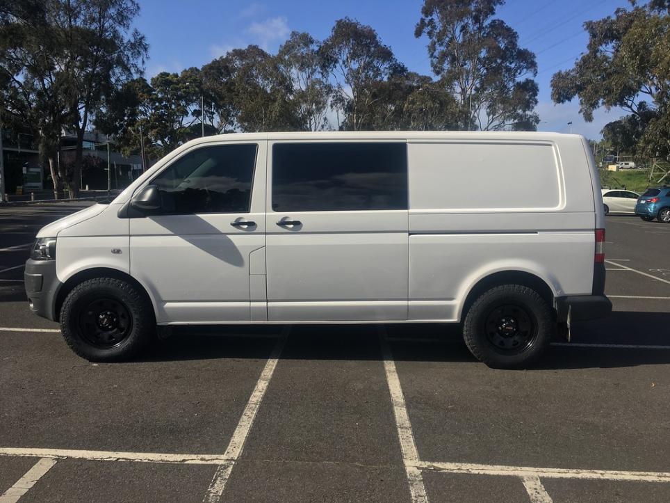

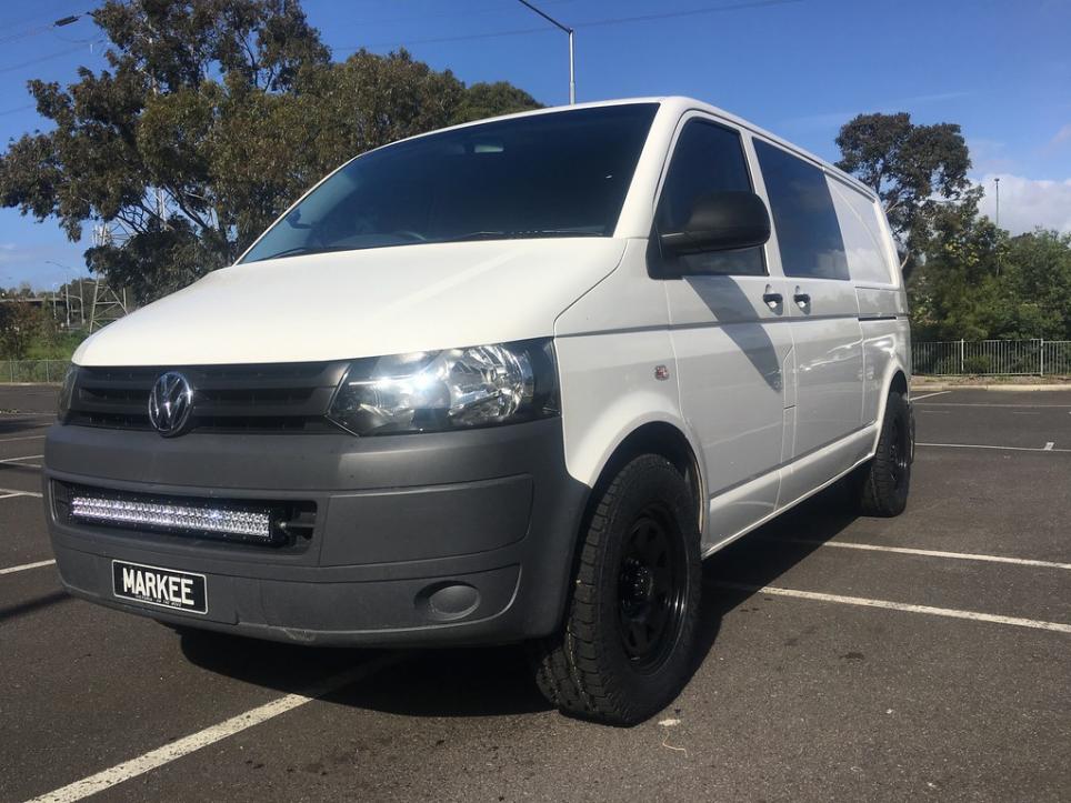

I'm getting Dynamic Wheel Co steel wheels in 17x7.5 ET30 with Toyo Open Country A/T II in 245/65x17, chose this package on recommendation from a good friend who owns a Tyrepower store.
