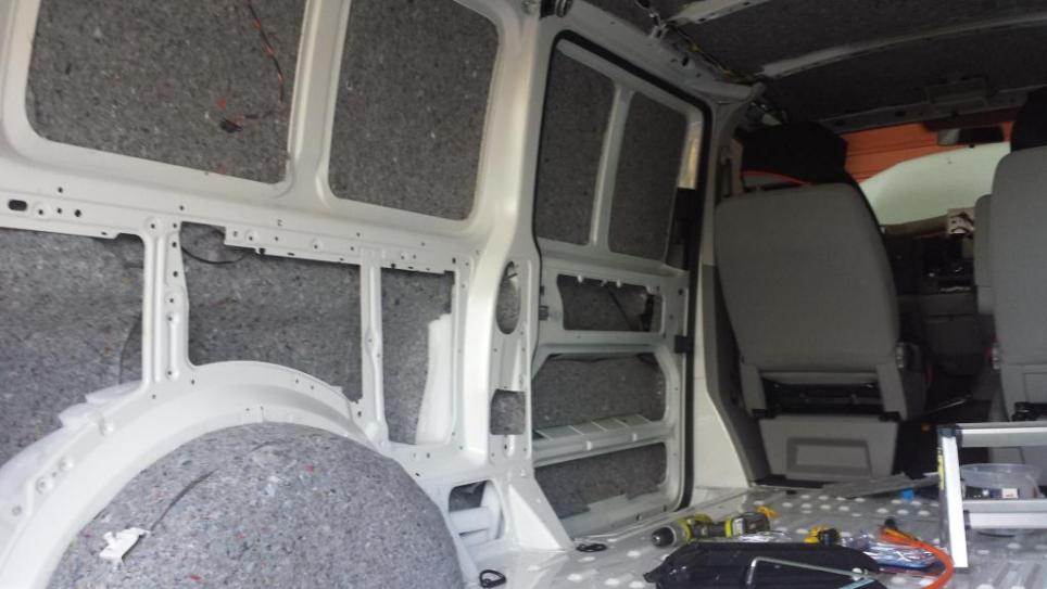

          Its amazing how much sound deadener you can stuff into the walls and doors etc of a van , so far over 24 square metres and still a bit more to go , roof now done / side door and tailgate plus all the sides and window spaces . I have run all the speaker wiring and amp wiring etc from the head unit to the amp under the drivers seat . Refitting the original side trims in readiness for then cutting and customising ply walls as customer wants clean floor to ceiling look , a whopping 12 inch Subwoofer is being built into the rear corner in a custom built MDF enclosure . I used lots of a special packing foam to fill out some sections as it cuts down any chance of any rattles and helps absorb any noise transfer . Sorry about the two blurry shots .

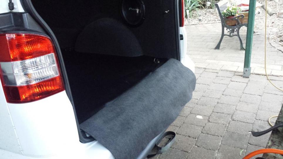

                            Rear bumper is painted so there is a protection flap to stop scratching .

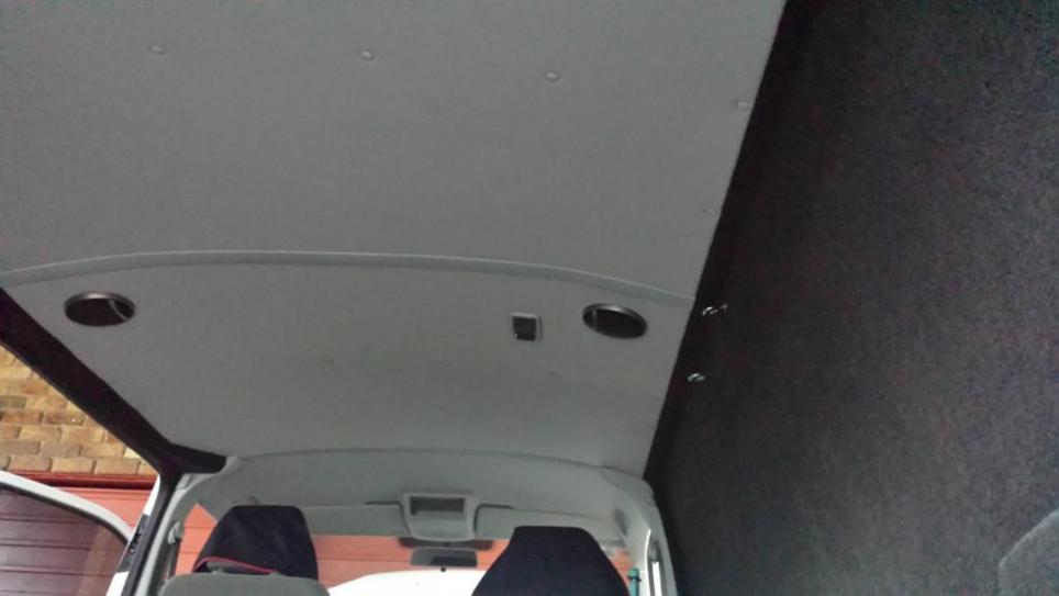

                            Roof trim covered with velour and extra speakers fitted to roof .

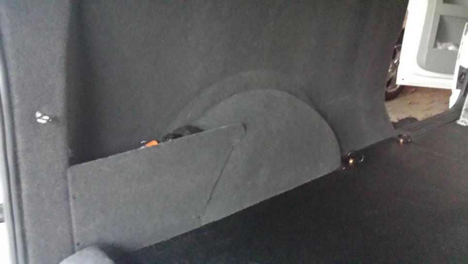

                            Storage cover at side for jack and some tools .
                            Subwoofer enclosure and drinks holder just above .
