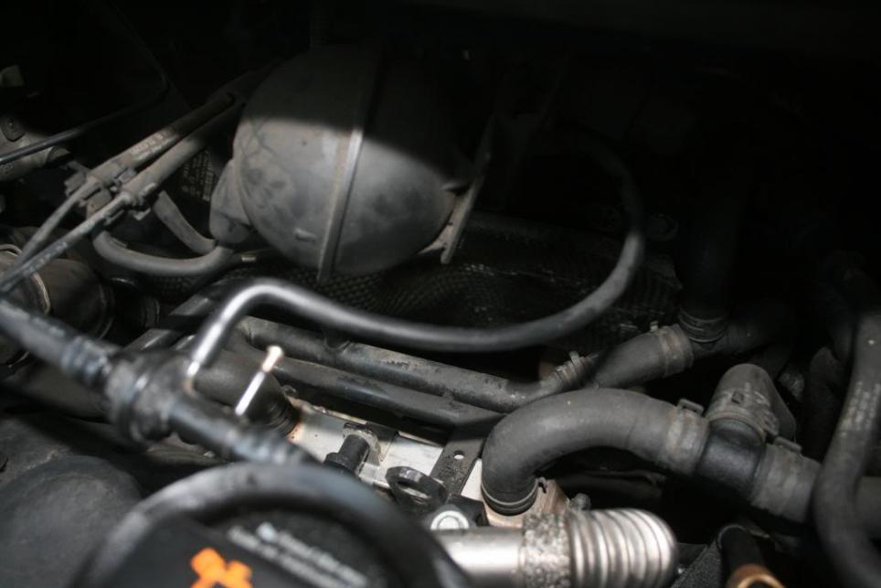

Okay what was it you ask well simple small things can kill an engine , I checked MAF looked all fine [out of interest with MAF disconected it was 50% worse would not get up hill near home] any way I was about to give up when I found a tiny vacuum hose from the brake vacuum line laying loose in the engine bay . It took me quite a while to find out where it had come from as it turned out without pointing fingers at HighwayV trouble where it was last serviced someone had redirected the main vacuum line in front of the oil filler cap instead of behind it this had placed the flexy hose to the vacuum resovouir under tension this caused the small connector to snap of right on the non return valve . Because of where it was placed it was not at first noticed so I luckily had a spare valve from an old T4 engine in the driveway fitted it and reconnected the hose and success all fixed WHEW This photo shows where it was located and the second where it should have been [IMG]
[/IMG]
