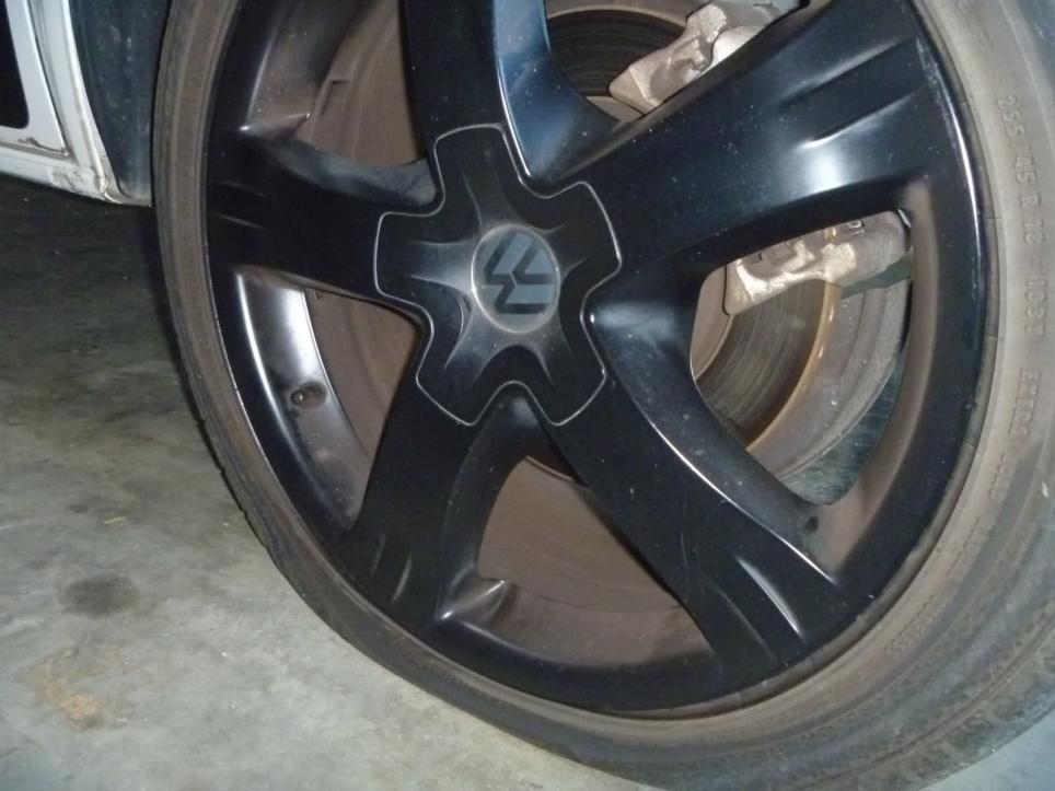

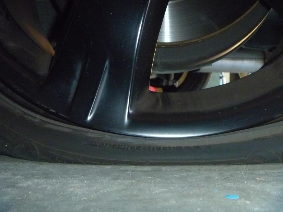

    Never seen a flat run flat but I thought the sidewall was supposed to stay rigid? What do you reckon? A new tyre needed now? This was from driving 100mts. 100km? Yeah right.

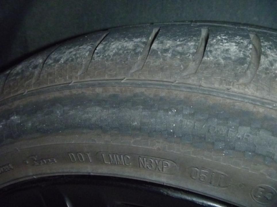

      Your lucky you dont have to buy a new wheel after driving that far on a flat tyre!!
      What made you think it was a run flat?
      Rob
        The salesman told me.....? I think it was him when he was explaining the mobility kit. Or maybe I just misunderstood.
        Anyway - id say it will be off the road for a few days because I cant see any tyre places having this particular tyre in stock. Definitely going to look into a spare though.
          Runflats are really not worth the compromise in ride quality for the sake of not having a spare.

                        Not sure about sidewall damage but im getting another rim and making a spare out of the damaged tyre as I am not a huge fan of plugs.
